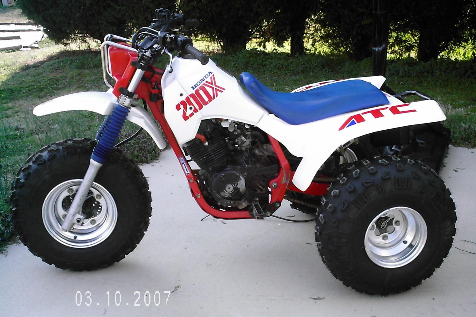

    NC
    907
    Sounds like an 86 to me.
    86 - white front & rear fender, red gas tank scoops, Honda wing on tank, large 200x on rear fenders, ATC on sides of seat, Honda on the back I think
    87 - white front & rear fender & gas tank scoops, Honda 200x across sides of tank & scoop, large ATC on rear fenders, just Honda on back of seat, key switch & dash in the center of the handle bars
    Pic of 1 of my 87's
Name:	87 200x 018.jpg

    Quote Originally Posted by 200x350xtriz250 View Post
    Pic of 1 of my 87's
    Sorry, He is rite I looked at mine its been a wile lol.
