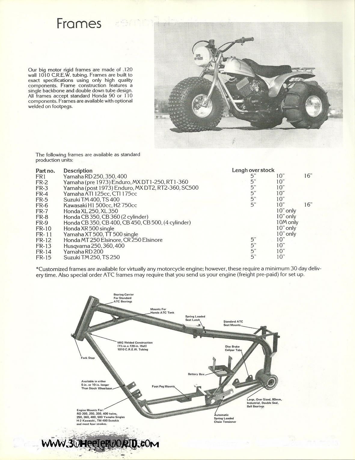

    Glad to see this trike finally get snatched up. Now get those rear fenders off and let's see exactly what you have. I think it's a Hi Performance ATC frame, but, I could be wrong. If it's a non-reed engine, it could be an R5.

    I found this brochure and this is definitely the frame, it is rigid no suspension. Tonight I will get the fenders and tank off and take some pics.
    http://www.3wheelerworld.com/attachm...0&d=1292639667
