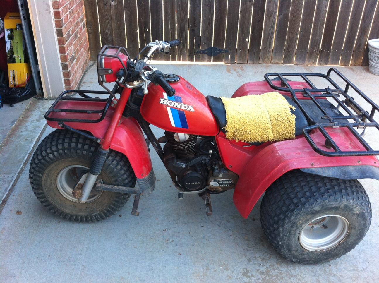

    Running beautifully. My daughter drove it down to the barn tonight.
    Here are some pics.
    Ain't she beautiful? The yellow is an attempt at patching the seat that my grandfather did with a bit of carpet. Still holding tight.

    Awesome! I knew you would get it. Fuel/Carb problems are a pain but they can be fixed with time and little money. Did you find a better o-ring then i take it? I just got done tearing mine apart and replacing that o-ring between the intake and engine as well, no more roaming idle depending on temp outside. Finally! She will sit and idle smooth indefinitely now without any change in engine speed.
    Nice looking 84! The racks and plastics look pretty good on the old girl. You can get a new seat cover for about $25 off ebay and they aren't that hard to do, or if you have a local upholstery shop they could do it pretty easy to. The nice thing about the 84 seat is the contours of the seat pretty much let you stretch a piece over it and done. Mine is still on its stock cover believe it or not. When that goes i plan on having a local shop redo it in real leather, why? Cause the guy is an artist with cowhide and it would sure look nice.

    awesome!!!! looks like its ready for another 30years of fun!!!!!!!!

    Nice and Good Job! Now just when the time is rite pass it down to you kids.
