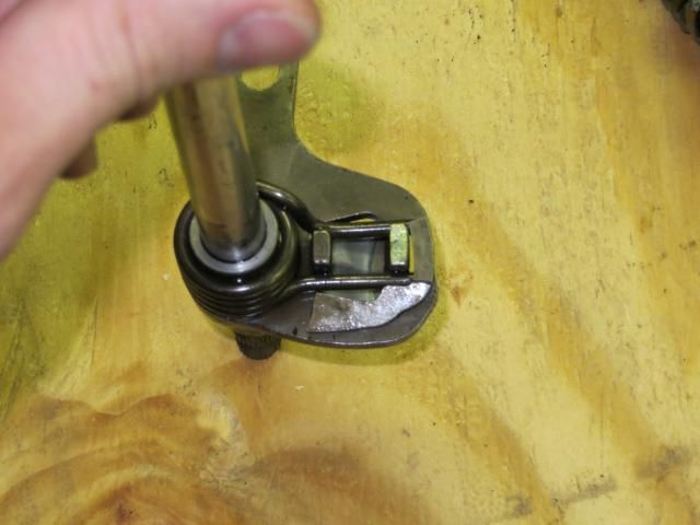

    Thought I'd resurrect this thread, it has the best potential of becoming a reference going forward. Found another 85-86 difference tonight:
    When this part breaks away, you can no longer downshift...you can only go up:
    17,489
    Maybe your manual clutch adjustment is off just a hair. They usually don't break there..............
