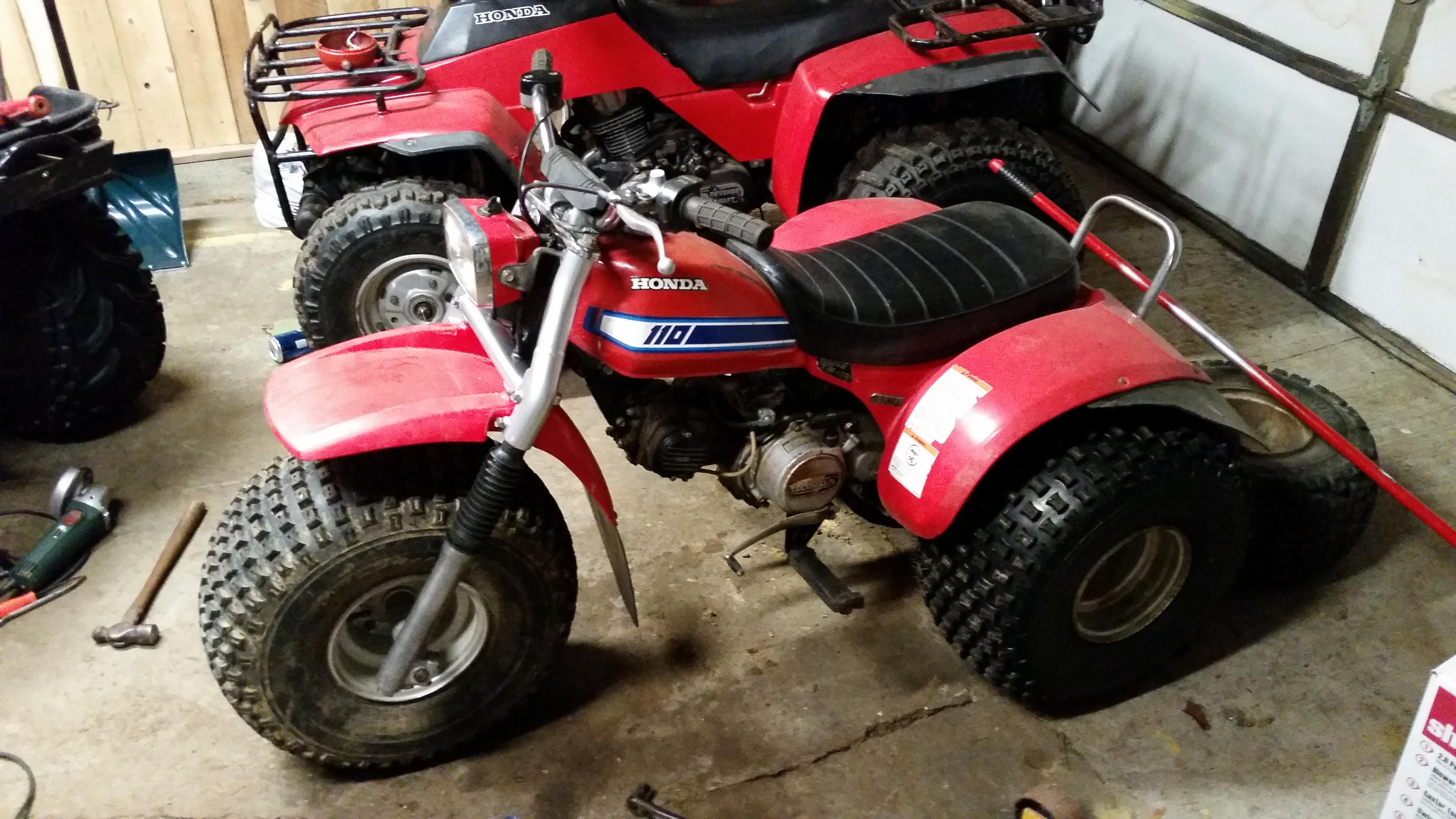

    Well after nearly 3 years I finally found some time to get the front end swapped. Still have to buy another 200s front fender. The fender in the pic I borrowed from my 85 200s for the time being. I also have to weld a new steering stop on as this front end uses a different setup than the original.

    That is dedication to update your thread! Makes a good resource for others. Thanks!
