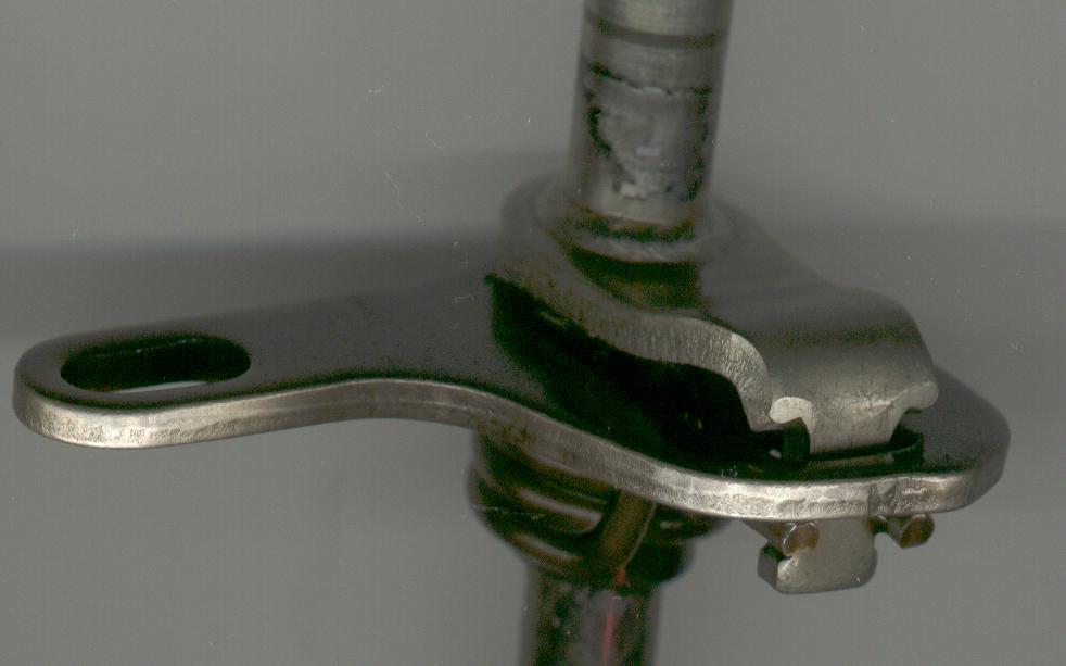

    Get a
    service manual
    use the search key for shift problems 250
    ak TONS of pictures before you disassemble.
    Mose of the complicated stuff is under the shift side cover so get a gasket.
    commonly known as 'shift linksgae with 1,000million tiny parts.
    Lay trike on its side, pull left cover
    Turn off the phone, warn friends to not try and help and have a look.
    Make sure you take tons of pics.
    The service manual only tell us to reassemble in reverse order.
    We ALL need to know the answer to this.
    ps
    first pic is right (wrong side)
    the other 2 are what you'll be looking at.
    tiny springs that can fly into oblivion across the most sterile garage / workshop.
