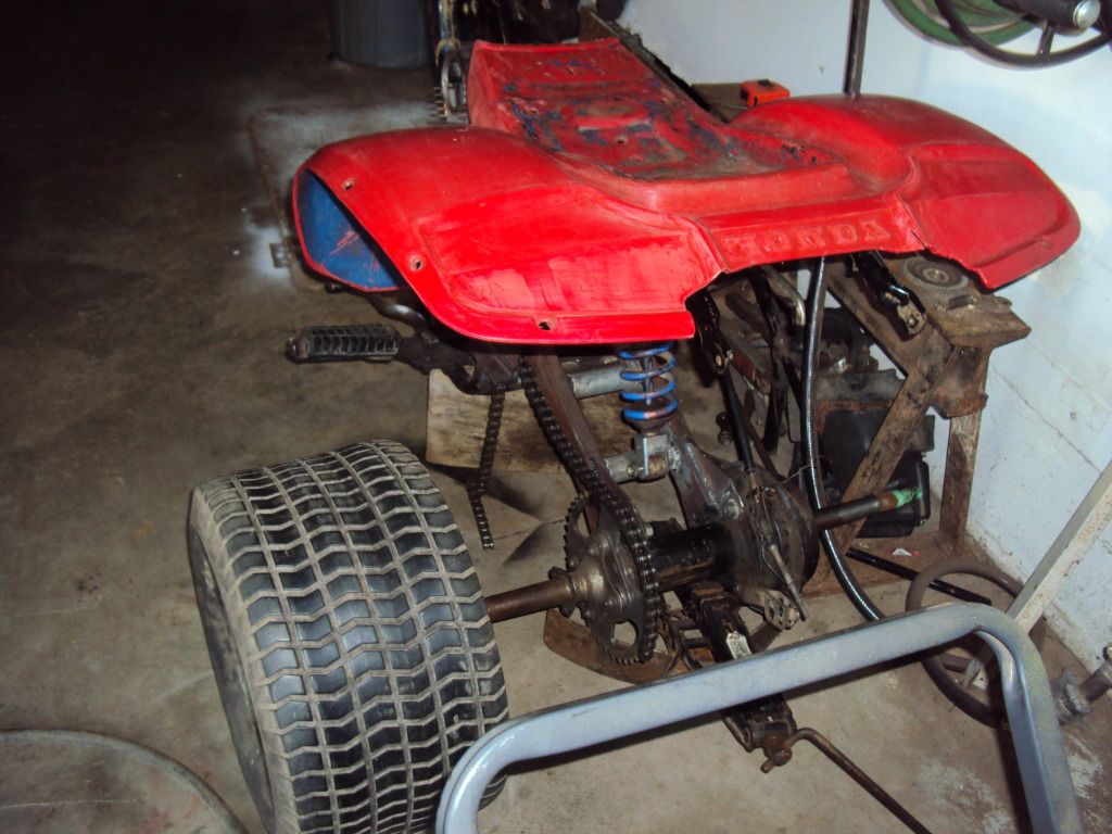

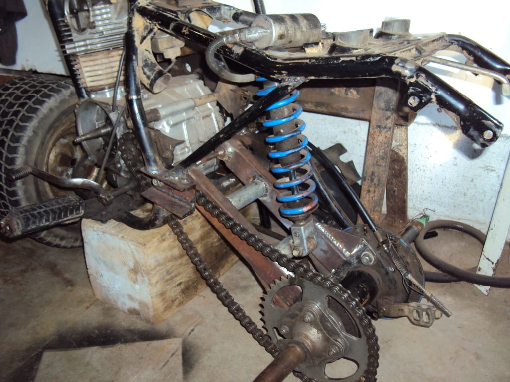

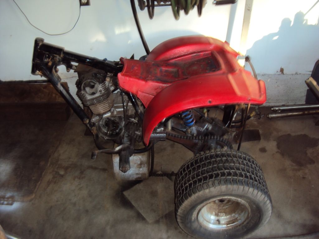

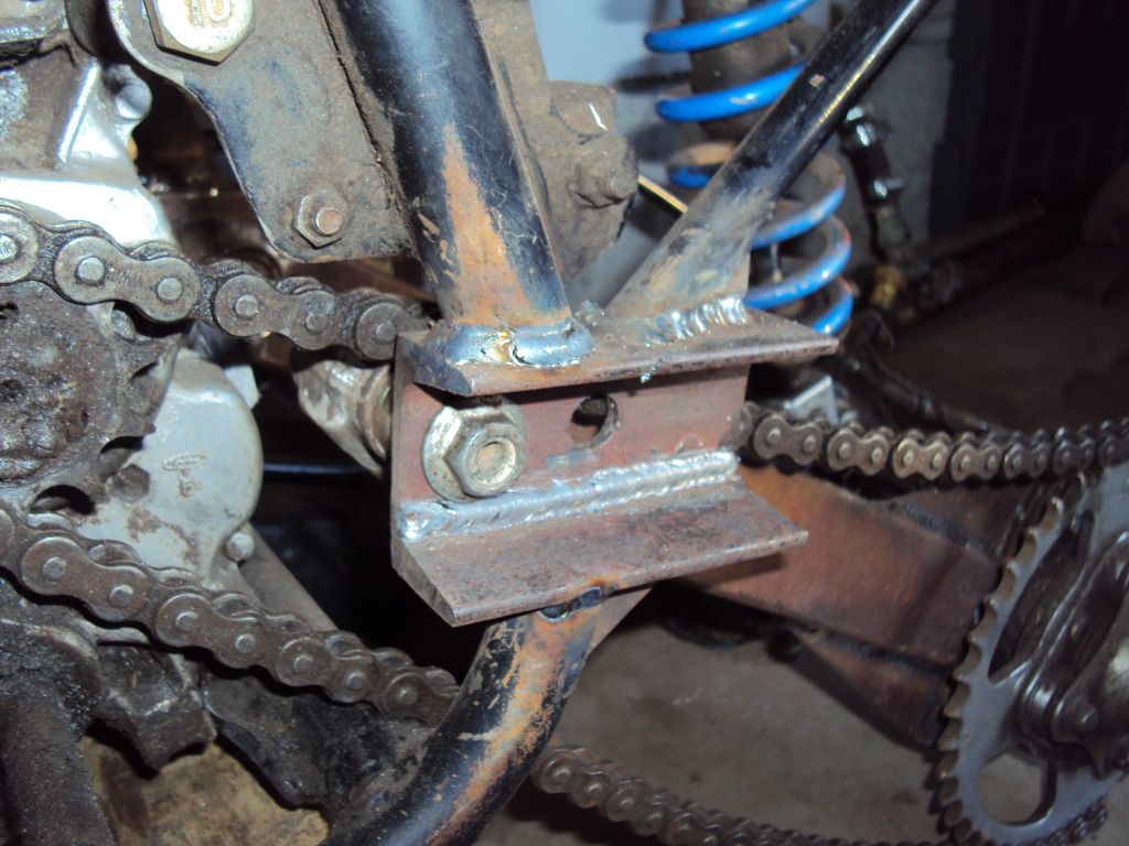

what you can do .. time consuming as hell,,, figure out where your swinger will be top and bottom of its travel. then set it up at mid travel.. the swinger bolt should be exactly centered between the countershaft and the rear axle,,, that is about as good as you can do,,,
