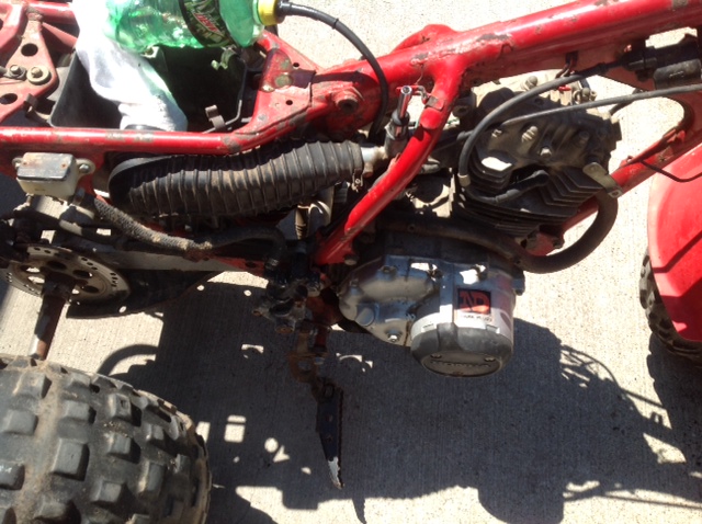

    Alright so some one was giving away this gem honda 1984 200x at a yard sale so i picked it up so far i got the engine wiring together and got it running thing is, i have no idea where/ if there is a clutch on this thing. I can shift it up and down but it feels like its always in gear i believe its a centrifugal clutch perhaps? Getting ready to hook up the brakes as there are no brake cables or clutch cables, just want to make sure this thing isnt going to start and just go but that it will wait for some throttle. also there are some tubes coming out of the engine casing that connect to nothing, they are about 3/4-1 inch in diamiter. as you can tell i have no clue what im doing but kinda know my way around small engines So my questions are
    1. Should there be a primary hand clutch?
    2. What are the tubes coming from the engine towards the back
    3. is this more trouble than its worth??

    That's a 200x with a 200s motor. To each their own but it bugs me when people do those conversions. Now you are stuck with an auto-clutch unless you want to go pick up a 200x motor.

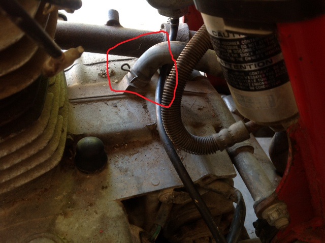

    Take a good close up picture of the tubes you are referring too. At this point I am guessing crank case breather tubes.

    Ok so there's the levers w no gear on them I believe one is suppose to be a clutch? Is that correct? And a pic of the carb missing the throttle choke mech and lastly the tube I'm not sure of its function

    where you drew the red circle...those are crank case breather tubes...you need those. Also, yes, it looks like the PO (previous owner) left the clutch perch on the bike, but you won't need it because the motor in your 200x frame is a 200S motor. Centrifugal clutch (auto-clutch). What I am saying is you have the wrong motor in the frame. If you want to make it correct you need to go find a 84 or 85 200x motor. I have placed a link for a 200x motor below. They are relatively easy to find.
