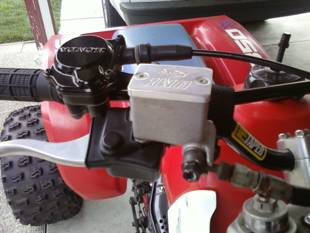

    Heres mine. I think its from a trx250ex. I ordered it on ebay for a 400ex but they sent me a different one than what was pictured, this one was actually better tho. paid around $30-$40. 250ex,300ex. and 400ex im pretty sure are all about the same and will work.
