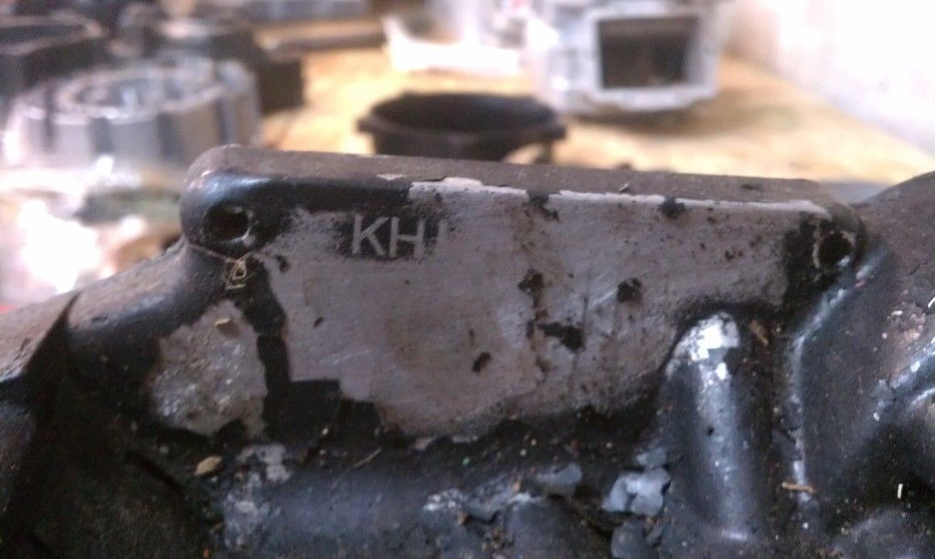

    I need to know what year KX500 cases will swap with what years. I have an 85 KX500 motor but want to find some new cases. Any one know what years are interchangable with regards to the cases??
    OH and how can you tell what year the motor is with out the Vin. fabio said he thinks it's an 85 but the vin has been sandblasted off the cast so ???

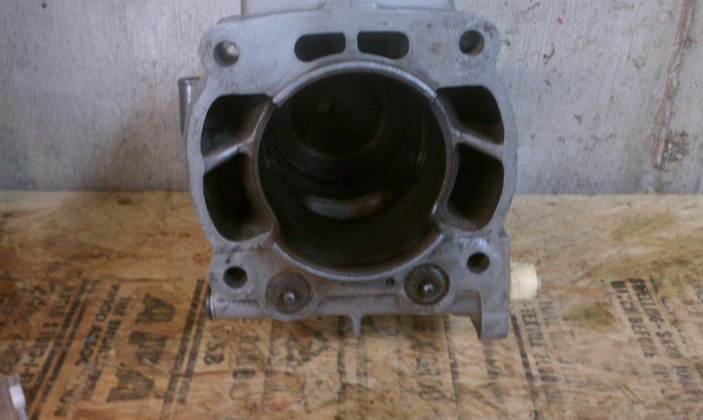

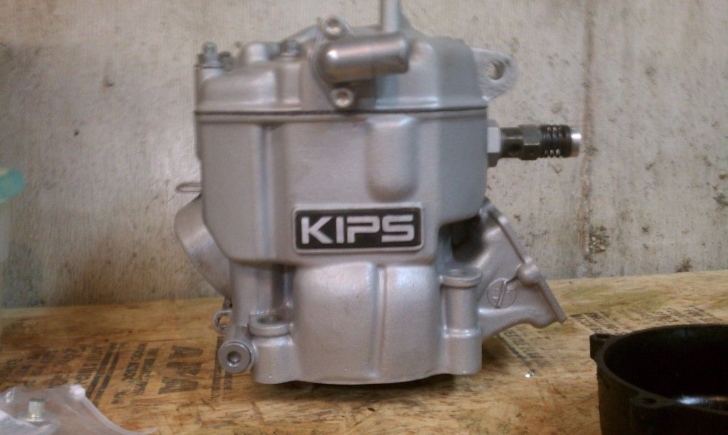

    The 1985 was from my understanding a one off year model that had liquid cooling BUT no power valves. Should not say "KIPS" on it anywhere.
    Served as a base for bottom end geometry but I do not believe any cases or top ends swap onto 1985 KX500 motor. 1986-2004 are all very similar.

    The 85 KX500 cylinder was a 1 year model

    I told you it's an 86 Bozo.

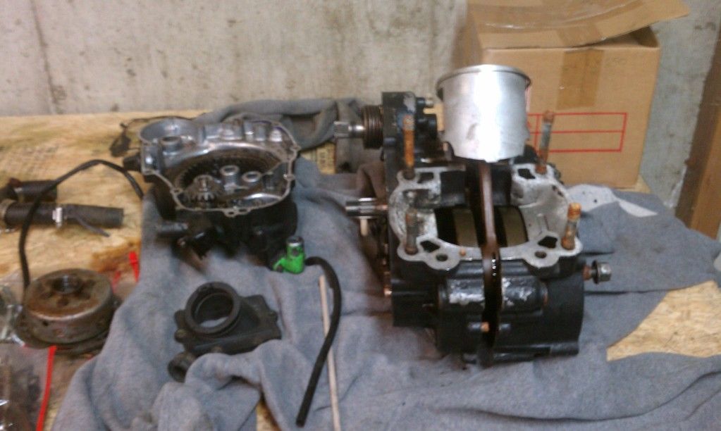

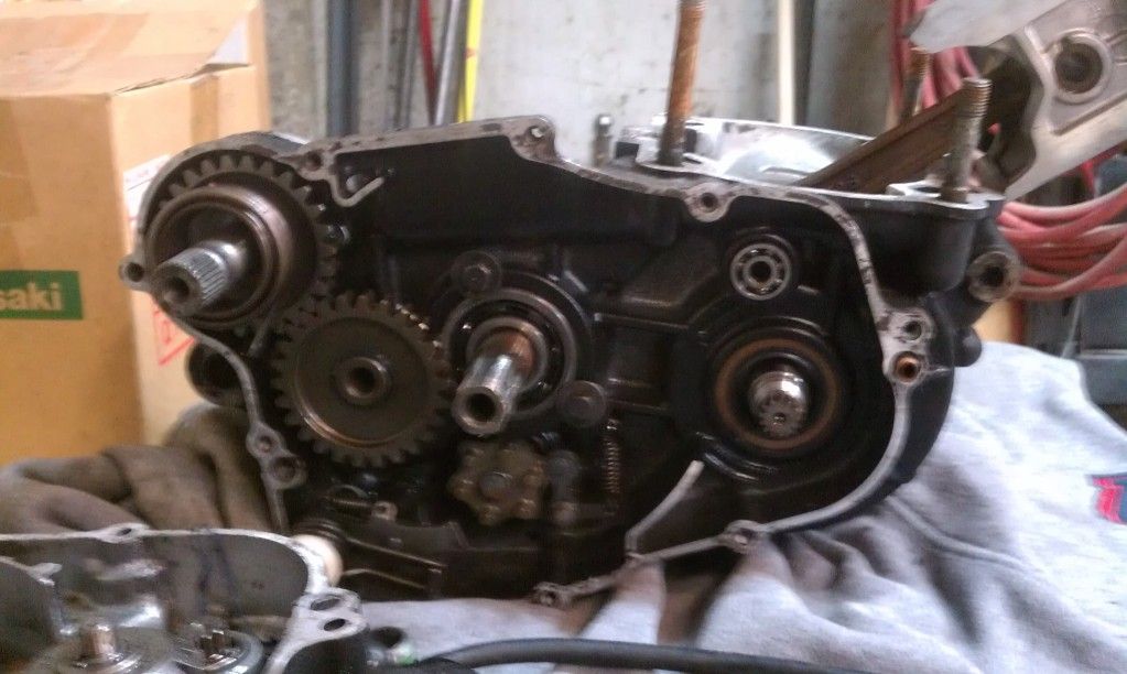

    Thanks for all the suggestions and I'll def check out those other sites and run through the parts diagrams. Will need to print for reassembly anayways. Here are a couple of pics. Oh and for the record this is not how i store my parts, All full of dirts and looking like a mess. It will be all squeaky clean soon and once I get some progress on the build I'll start a thread. You right Ben it's not to hard ot figure out what I'm doing but It's going to be a first gen not a second gen.... FYI Or maybe I should build a 500 missle like your 300? lol
