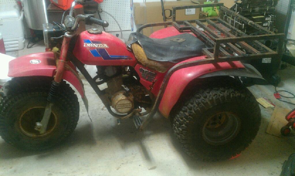

    Spitting out Oil!!
    I went to change the oil, and I opened the oil to see how bad it was cranked the 3 wheeler to warm it and it started shooting oil out from where you check the oil. little bitty spot all over the bike. Acts like I have a gunked up Top half. I really didn't want to do the rebuild but I guess I will have to! A guy down he road said he could bore it out and rebuild the top half for 200 in parts. Should i do that?
    Also here is a pick of my bike

    If it is just splashing out in drops, its probably not because it needs rebuild. Its probably the crank splashing in the oil. Not a bad trike for ony $100. You got a deal. Paid 5 for mine. Are you planning on the seat after you get it running? I picked up a saddleman kit from amazon.com, foam and cover for 79. And change. Thru Bigbadpowersports.com. Of course I had to install ift and I'm sure mrs. Mosh's. Seat would have looked better. But you get what you pay for. Sometimes anyway.

    Not bad for $100!! Looks pretty good!
