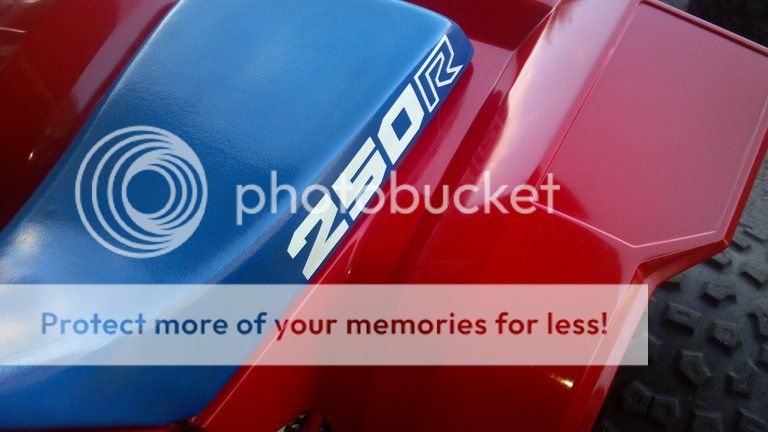

    Finished polishing the plastics on my R
    I started the fenders back in the spring and never finished them. I bought the tank at the spring St Joe ride it had been spray painted red.I'm slowly fixing the one up for a rider.

    how bad were they when you started (the rears) and what did you use to do them?

    Quote Originally Posted by userj8670 View Post
    Thanks everyone.... The rears had decent color but several deep scratches across the number pate area on both sides and heavy scratches along edges and boot area.i normally start with coarse sand paper just on the gouge or scratch areas till removed and work my way up to 1500 grit wet paper then buff with 3m buffing compound followed by a swirl remover polishing compound.

    what type of buffer did you use and what swirl remover?

    Quote Originally Posted by honda200x1987 View Post
    Makita rotary buffer ,with wool pad using the 3m buffing compound .i use
    3M Perfect-It 3000 Machine Polish Swirl Mark Remover with a foam pad and also use 3m finesse .

    Wow looks great! I'm slowly building up the courage to try that myself. How many hours do you have in those plastics??

    Beautiful! I have a perfect Maier rear fender that sat in the sun for 8 years. I'm going to try the Perfect It on it soon. Do you sand first? I have minial scratches, just need to get the pink out.
