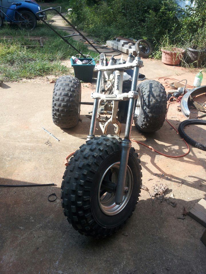

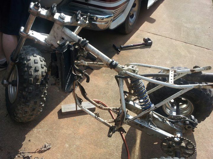

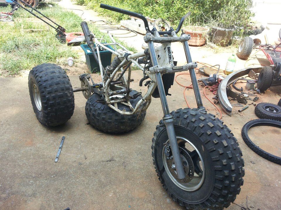

    Alright guys. I've been wanting to build a custom trike and you guys might have seen my other feeler threads. but this is for real, and its happening. I waited until I got some progress done and knew it would all work (for the most part) to get this thread up. Its a 1990 Honda CR 80R 2 stroke dirt bike, with a 1st gen 200x front end including triples, and a 1st gen 200x swingarm, axle, hubs, ect. I bet your wondering, what did I have to do to get this all to fit? Well, it was very simple

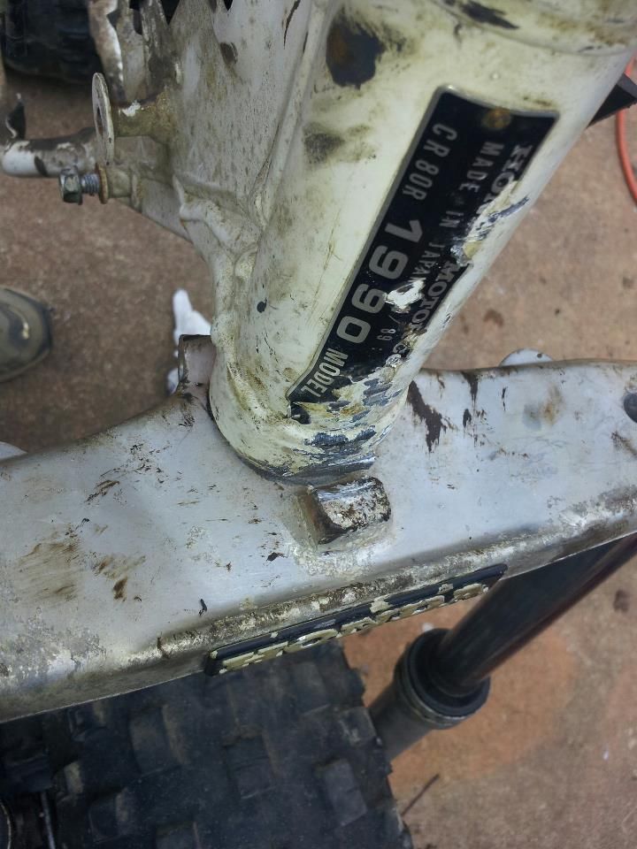

    Front end: The triple tree front end setup off the 200X bolts tight in the CR 80 head tube on the frame, the rake looks good and the only problem I ran into is I need to cut the fork stopper off the CR 80 frame as it hits the stock 200x one on the bottom triple clamp. other than that, its all bolt on n go!
    Swingarm: for the swingarm, I had to cut the pivot bolt tube on the right hand side flush with the actual swingarm, about 1/2 inch of material removed. this allows the swingarm to be mounted (with a space on the other side) and the sprockets to line up perfectly. I am awaiting bearings and bushings for the swingarm.
    Shock: I'll have to mess with linkages from the 200x and from the CR 80 and see if I can get something working, but it sits nice and level with it direct mounted, However I don't know if the rear suspension would perform well like that. We will see in the future!

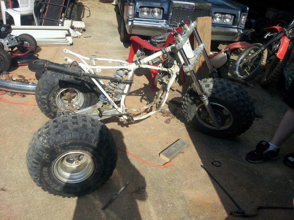

    Thanks! If it does get completely built and functional, I'll tear it down and paint everything and add some performance stuff. But, so far, its lookin like it'll work out. Tomorrows to do list includes chopping off the old steering stopper and welding in new ones, and cutting the swingarm to allow the CR 80 motor to mount in it. Then, I need to order bearings and dust caps for the swingarm. I also want to play with some linkages and see if I can get a nice combo of ride height, travel, and spring rate to make it handle decent. If I can get the whole thing set up as a ready roller, then onto the motor and plastics! I was thinking of using 200x rear fenders and seat, a 250R front fender, and a number plate. All that with the stock CR 80 gas tank.
    If anyone has any questions about the build I'd be happy to answer them.

    Nice mate.What ya gunna do for chain adjustment??

    Glad you mentioned that cause I forgot theres no adjuster in the carrier. Probably just a chain roller piviting on an l bracket, with a spring for tension. it'll just ride the chain and keep tension like that.

    I think it's a great idea but how can you measure or judge the rake without the rearend set up yet?

    I had it set up the way I liked it without the shock bolted on earlier in the day. I need to make a linkage system for it.

    I got some more pics, of plastics set on and of where I had to cut the steering stopper off the CR 80 frame
