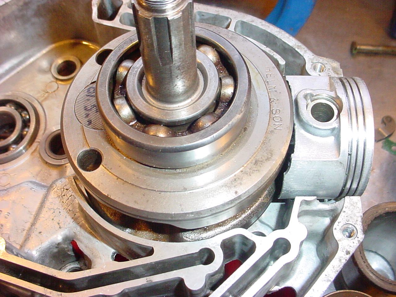

    I'm making a base spacer, and swapping a longer rod, to go with the sleeved aluminum S90 jug.
    Cases got bored to 62mm for spigot clearance.
    Alloy jug.
