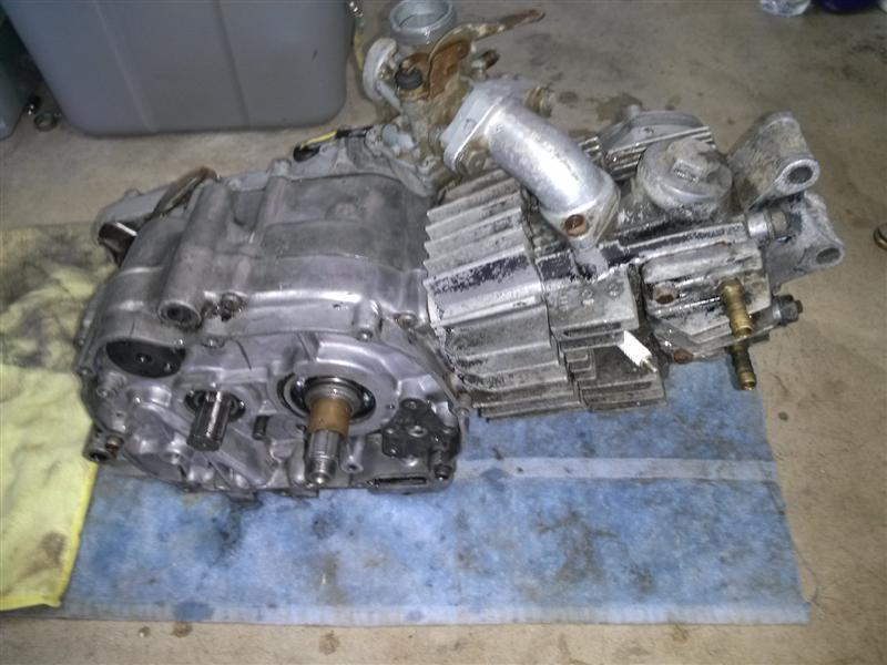

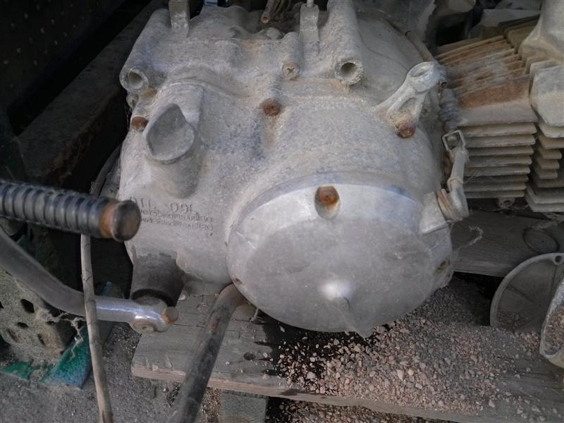

    Here are a few picts of a StarBurst I just found and a s90 for a clutch swap.

    Nice !! I see a spacer plate under that H&S cylinder ..... BIG thumper

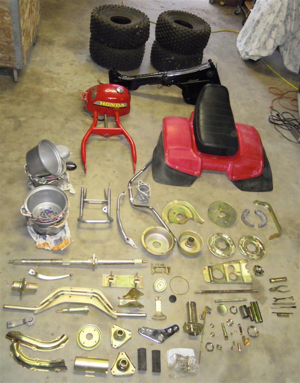

    Found the ATC
    Well I finally found the box's it has been hiding in. Plated and Powder coated the frame and rims about 8 years ago. Still a few missing parts, like the hardware and rear sprocket...

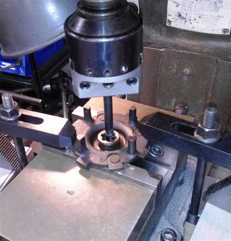

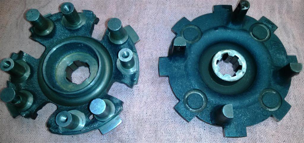

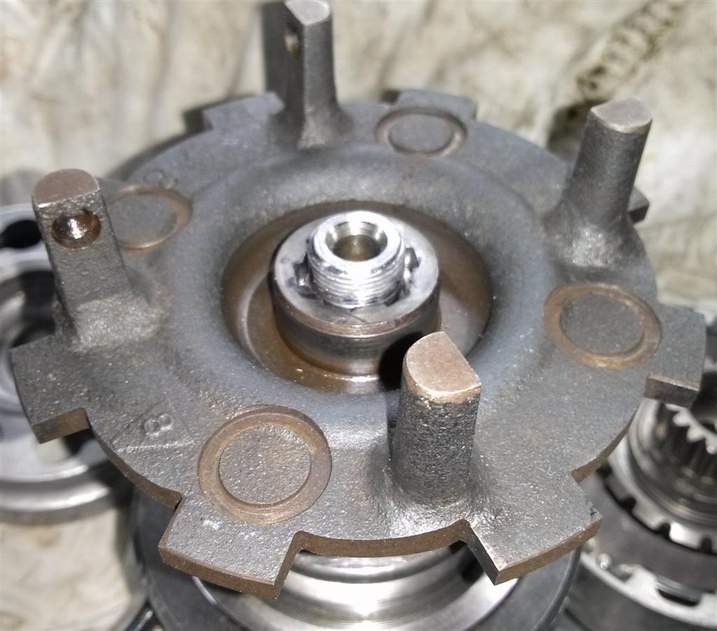

    S90 Clutch Mod to Fit ATC110 CrankShaft
    Found out I needed to get a SL90 clutch, not a S90 Manual clutch. But with some help, I re-broached the inner splines and opened to ID for a perfect fit.
    Stock Auto Clutch next to the S90 Clutch

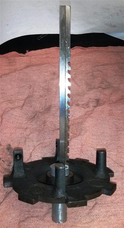

    Broaching the inner splines to increase their width and depth

    Boring out the Inner Diameter

    De-burred and Test fitted to my crankshaft, slightly tighter fit than the stock clutch.
Name:	S90Clutch-4 (Large).jpg
ID:	155606Click image for larger version.
