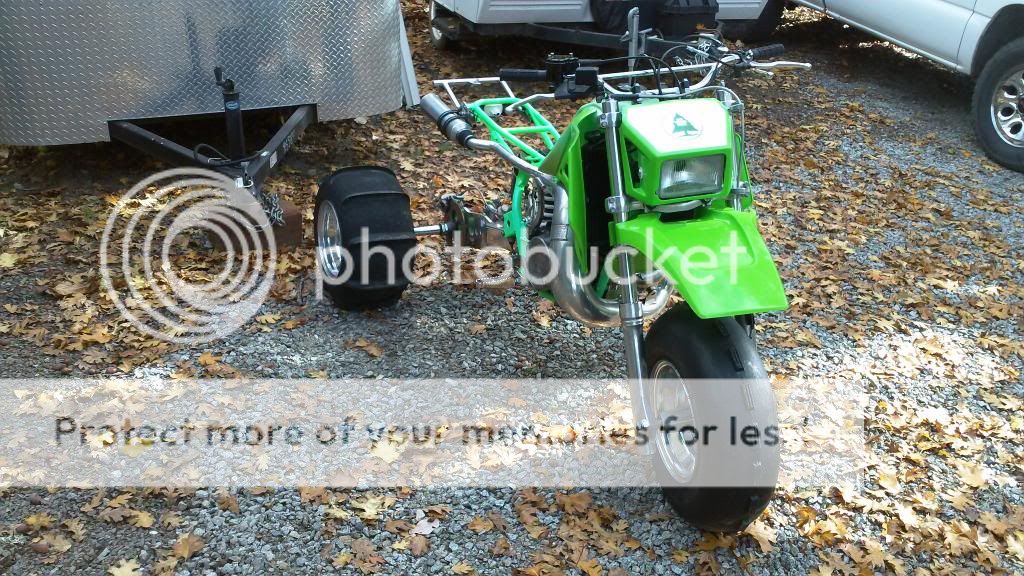

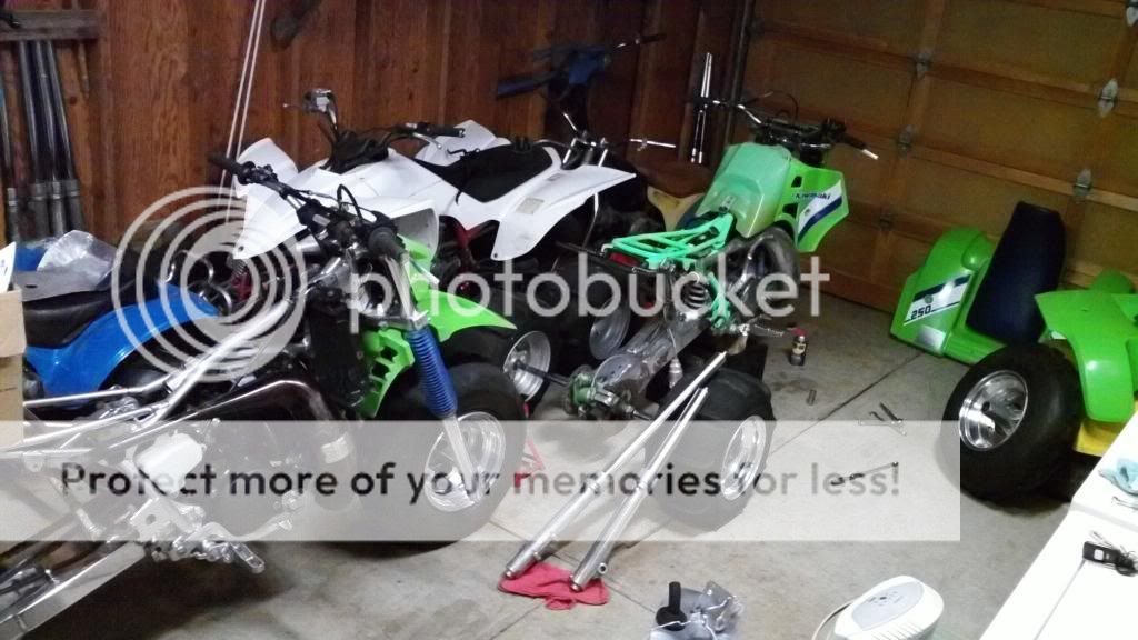

    Ok guys, I got some progress made! I put a new Clark gas tank on my 87 threw the old one on the 500. I tried to revive two different OEM front master cylinders, but they were too far gone (I wish I could get back the hours wasted drilling the stripped screws that hold the covers). I ended up buying a Kawasaki Prarie master because it looked close to stock and was 25 years newer. Resealed the forks, new clutch cable, chain rollers, outerwear, chain, painted some stuff blah, blah....... I polished the forks, tripples, swingarm, silencer, wheels, etc. I'm no G-King but I'm trying lol. Here's a pic of the mess.
    I got it put together and drug it outside and proceeded to kick it......... with a boot on of course. I left the rear fenders off knowing this was not going to be easy. I had sprayed some oil in the top end when I got it so it fired up and immediately fouled a plug. Put another plug in it and got it running. Damn this thing sounds mean, revs very quick with awesome throttle responce.
    It warmed up and proceeded to spring a leak from the lower radiator hose. It was also pouring oil from the countershaft as it was spinning (didnt have the chain on). I fixed those issues and put it back together-
    This is where I'm at now (damn I need a decent camera). I still need to get my other G-Force hubs put on to make it a bit wider (I will probably sell these). I'm fairly certain the compression release is not working, I wore myself out kicking it. The cable looks a bit suspect and I'm afraid to unscrew the assembly from the cylinder as it seems very tight??? What exactly moves when you pull the cable? Sounds stupid but I can't really tell what part is supposed to move. Fabio? I'm headed to the dunes in a few days to give it a shake down, wish me luck!! I will have some video for you guys if all goes well!
