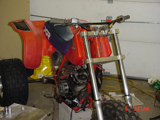

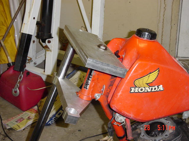

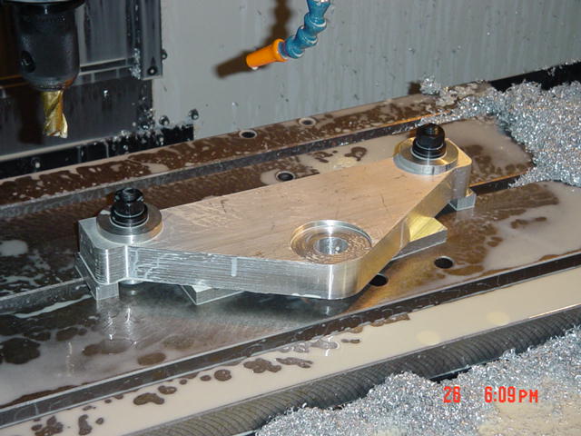

    I received 2 PM's on this, they will get first crack if they have the ability. We should probably keep this in the open after them so please post your thoughts here. I'll go into more detail of what's needed. It's been 10+ years so my memory might be foggy.
    You will need machine tools. Those triple clamps were our first GUESS at geometry, they should be considered useless and good for 20 feet or less. There is a lot going on up there because the forks needed to move forward to clear the tank. The 500 head is so wide and high an atc tank wouldn't work. I believe the fork holes are bored straight thru and we put the angle on the stem mount. The odds that angle is even close are remote but we needed something. It's a best guess.
    The swingarm should be good to go after mounts are made. There was a shock link mount but i haven't seen it in years. We never got to a brake mount.
    I believe the only frame mod up to this point was bending the rear subframe tubes down a little to clear the plastic.
    This isn't something that just requires assembly. You will need manufacturing ability.
    I'll add more after work today. I'll post construction pics so you get an idea of what is required.

    I saw what your cousin did in the other thread just now. If you can get a decent C-shaft to pivot height and avoid the chain bind that looks like a good way to go. That always seems to be a tough balance with swaps. The more i think about it we must have made the clamps because the numbers were too far off. The head angle and much longer forks of the 500 would have really thrown the rake/trail off with 250 clamps. I have a pic of them mounted so we must have tried.
    I don't think any other chassis would have accepted the dual carb 500.
