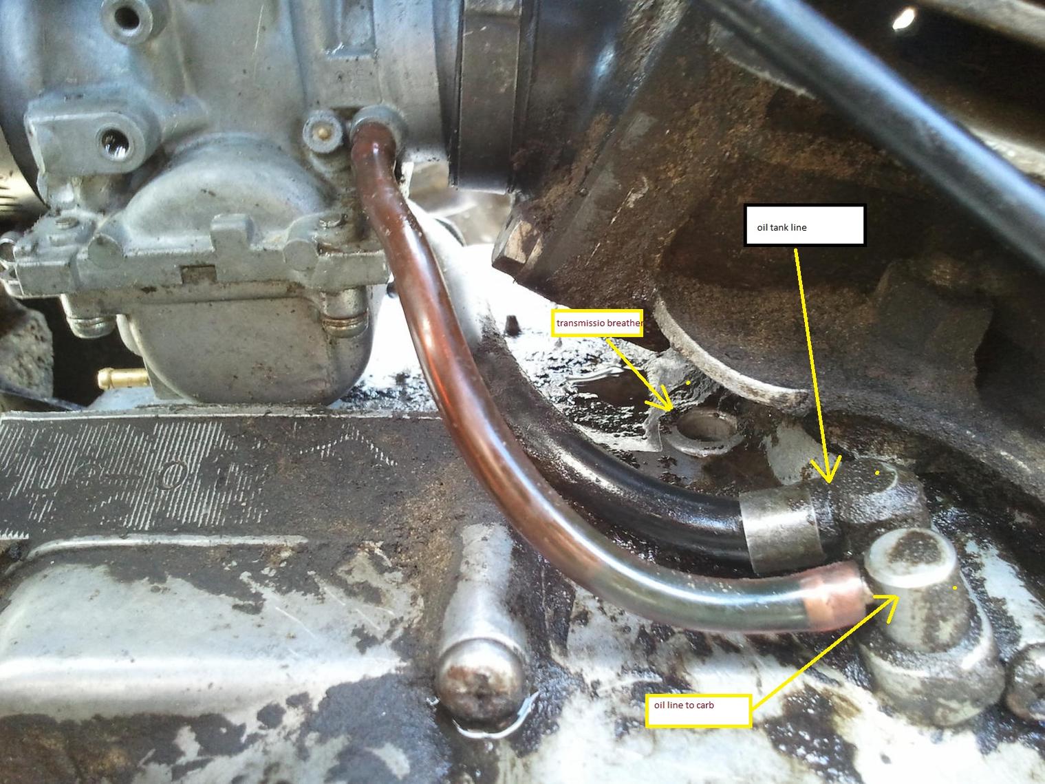

    1980 Yamaha TriMoto wont stay running!
    Hello All,
    I have a 1980 Yamaha 125 TriMoto I can get it to start by spraying starter fluid into the carb but dies once it burns that up. I am guessing that it is not getting fuel, there are several hose fittings coming off the carb, I know the fuel line, I believe one goes to the oil pump but dont know which. Would like and suggestions or info that any may have to help me with the situation.

    jfishbaugh you should start your own thread but here some pics to help
ID:	157805   Click image for larger version.
