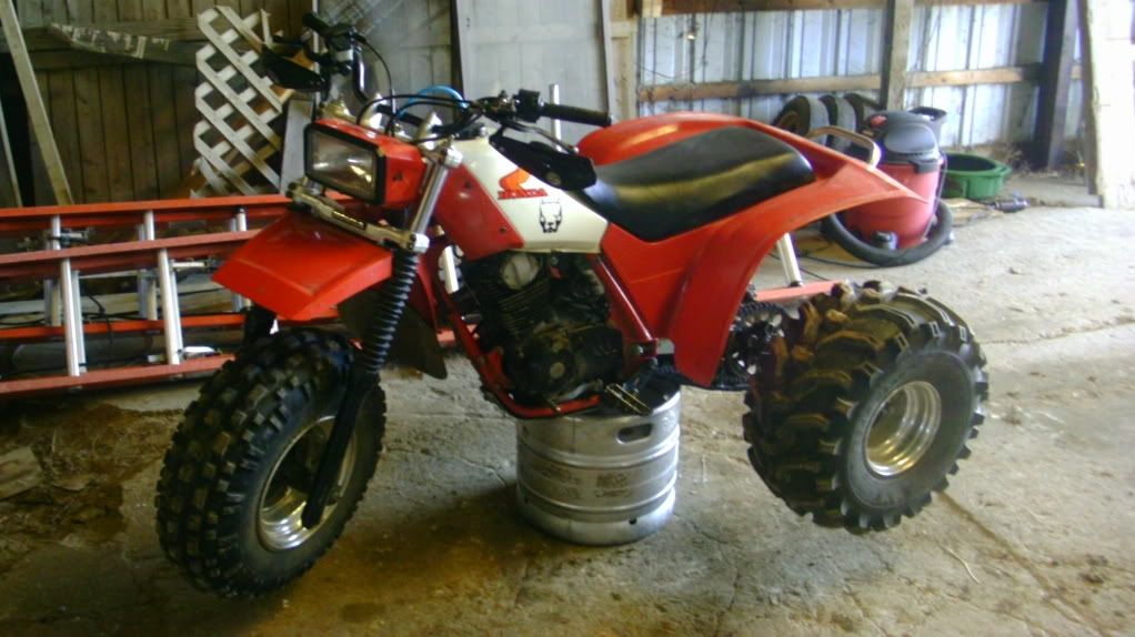

    I change my tire size from 22x12x8 to 20x11x8 on my 200x will i have to change the gear or sprocket, or will i be safe?
    currently running 22x12x8 bear claws and there not what i need as i don't play in the mud and snow that much, i'd rather get a 4x4 quad to abuse in the mud lol. so i'm thinking about grabbing some hole shots or what type of tire do ya'll recommend for trail riding and a lil road riding as where i live we can ride the roads.
