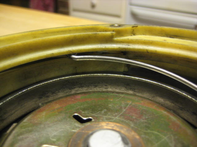

    place the SPRING, FRICTION over the PULLEY
    leave the top tab of the SPRING, FRICTION up above the top of the PULLEY for later engagement with the RING, HOOK CASE
    It does not matter which side of the SPRING, FRICTION is up or down... either way gives the correct orientation

    then, you see the RING, HOOK CASE with the PLATE, HOOK ; the decompression cable end is visible at its keeper
    you need to place the PLATE HOOK groove over the tab in the RING, HOOK CASE
    you can see the yellow plastic RING, HOOK CASE tab in the groove of the PLATE, HOOK
