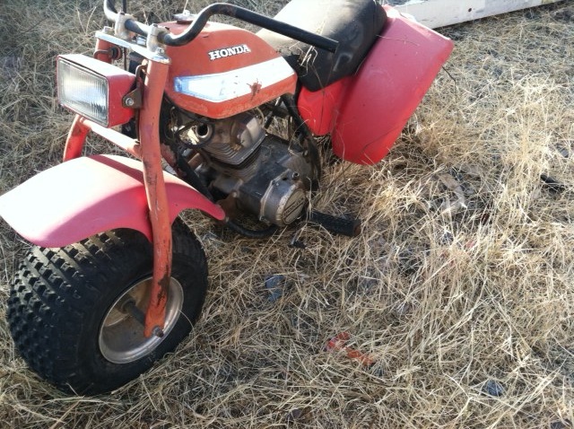

    Well I decided to try my hand at building a 185x. Craigslist provided a reasonably priced basket case '85 200x
    95% of the parts some on the bike some in a box all for $150, The next day I found a '81 185s parts bike for $30. I've been wanting to build a novice rider trike with full suspension and the semi auto transmission, my wife and sister love riding my '83 185s but don't like the bumpy ride out in the desert I really fell in love with the ride of my '85 200x so I'm hoping it's a good match. I understand that it is a sin to make the 200x slower but I am keeping a fresh 200x top end, I'm sure it will find it's way onto the bottom end of the 185 at some point down the road.

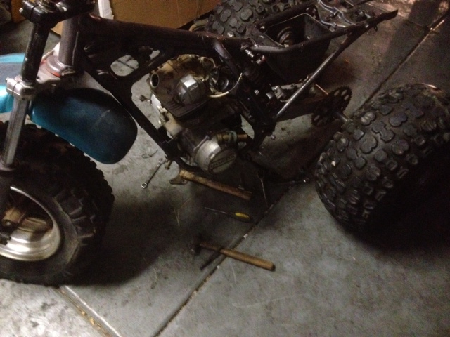

    I spent this afternoon cleaning the carb out, went down to the local bike shop and got a rebuild kit, and put it all back together. Then I pulled the motor out of the 185s and got it into the x frame
    The motor is still a bit off, I'll work on squeezing it in to place tomorrow.

    You will need the 200x motor mounts to install that motor in the 200x frame . It will bolt in like it was made for the bike with the right mounts .

    I have the 200x mounts on, I compared the two sets of mounts before I put the motor in to see if there was a difference. Right now I have the longest bolt on the back side of the motor in, the motor mounts are bolted to the engine and almost are in place on the frame. It's just a little off at this point, It was getting late so I decided to take a break last night. I'll get it in there this afternoon. I was looking at the space where the carb goes, it looks like it might be a tight fit, should I use the spacer tube from the original 185 motor or the 200 motor? I have the one from the 185 bolted up now, the one from the 200x is at my buddies shop. We were working on a top end rebuild for my 200x when I got this project 200x, I think we are going to use the project x motor in my 200x instead. Is there any difference between the two? angle of the bend, difference in length? Could I bolt the carb right up to the head with out the tube?

    You will need the 200x intake manifold to get the correct angle , the 185 intake wont work . The trick with the motor mounts is to leave them all loose and just get the bolts threw the holes and then nut them up .

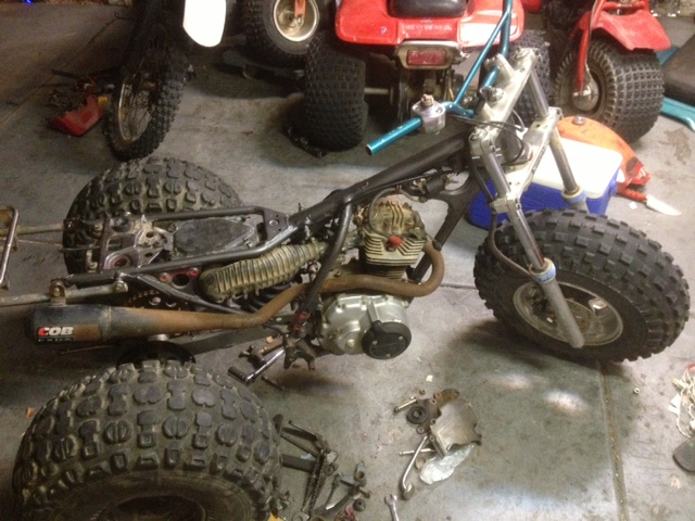

    All I wanted for Christmas was to work on my Three Wheeler! Finally after the hustle and bustle I was able to get out to the garage and start wrenching! The exhaust pipe is on,
    i got the air intake installed, the carb is on, the new front end is installed, six pack rack is ready for action, the chain is adjusted, I got the 185 chain guard to fit with a little tweaking

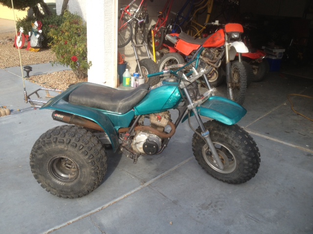

    I put gas in the carb and it started leaking straight out the over flow at the bottom of the float bowl, I'm gonna need to pull it apart and go over it again. I put the tank and rear fender on to get some inspiration.

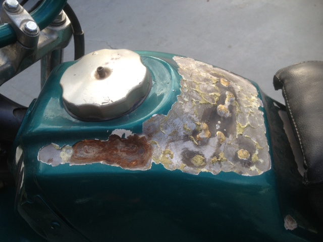

    Any Ideas on this tank? This is how it came, it's sealed but very ugly. I'm thinking I can hold out for a few months till I can find a new one.
