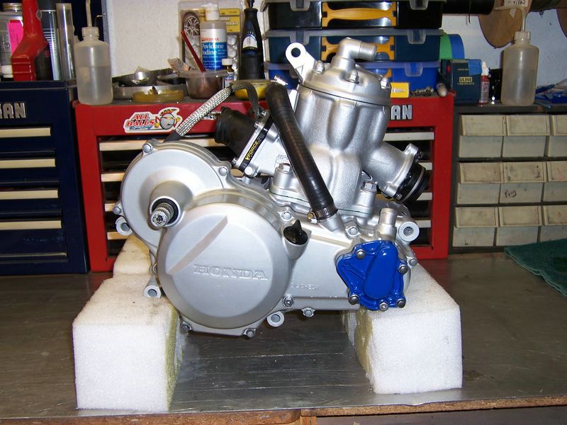

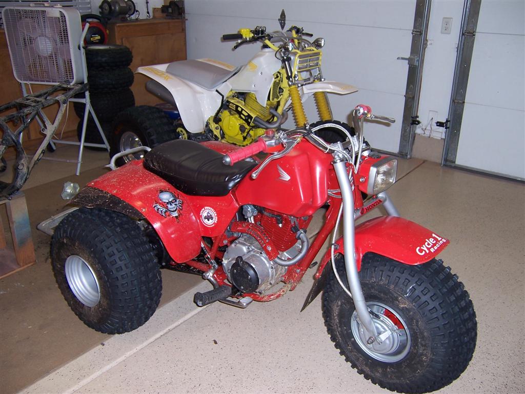

    Jan 2011
    Choctaw, OK
    2,755
    If you were very careful, you can sand blast the motor as a whole just to get the old clear and corrosion off. Then degrease, power wash, and rinse with rubbing alcohol to prepare it for painting. My 185S motor was completely disassembled and bead blasted but I have done whole motors with almost as good results. Clean clean clean is the key.
