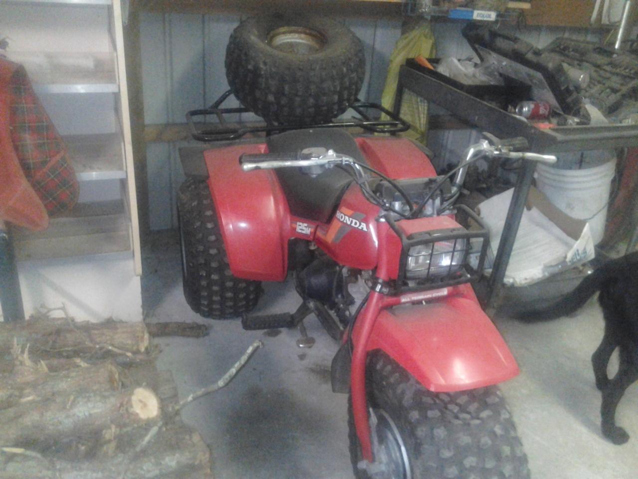

    Little 84 125m I picked up last week...runs great!
ID:	161138 Great find for 400 bucks...put on new front tire and in the process of cleaning the tank out. I have a extra front tire and extra rear rack if anyone needs em. Cant wait to get the tank back on and ride some trails

    looks good

    thanks! I couldnt pass it up!

    Looks really clean! How's she running??

    runs like it just rolled off the showroom floor. had a lil rust in the tank down in the corners working on getting that cleaned out. had to replace front tire, it wouldnt hold air due to dry rot. gotta change the oil and I will be ready to try her out! prayin for some snow today!

    What shape is the rack in and how much?

    Dang...you scored good on that one. Sweet looking trike. How are you tackling the rust in tank issue?

    awesome score.... thats nice....great job

    apple cider vinegar Big G, it worked great.....thanks 123456q. snow should be startin in about an hour got the big red and 125 ready to go!!!

    Vinegar removed the rust?

    yea but make sure you use apple cider vinegar and let it soak for 24 hours, then rinse it 4 or 5 times with baking soda and water. let it dry then fill it up with gas
