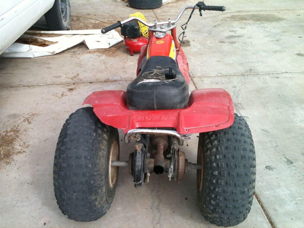

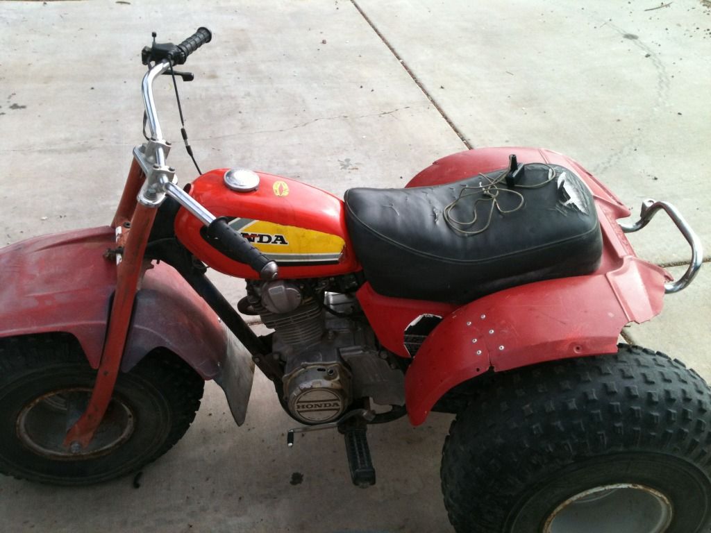

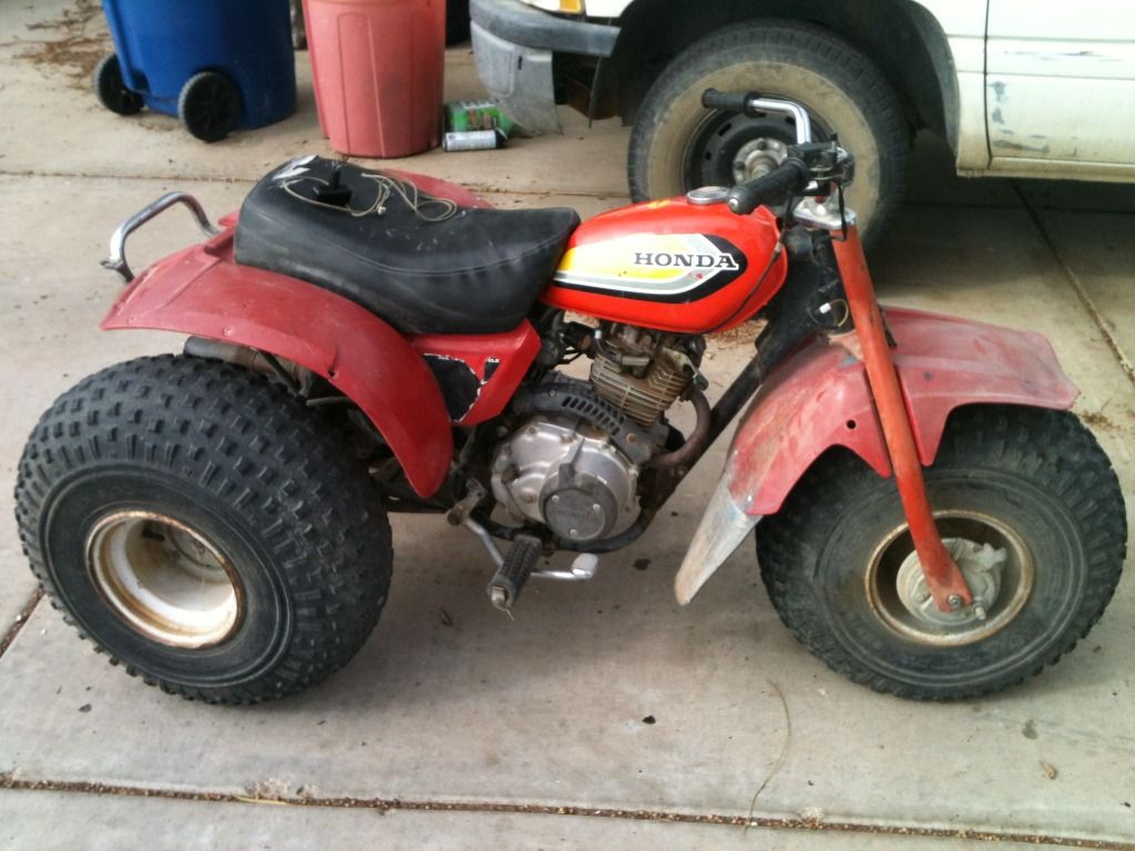

    I did run the vin it's a 1982 Honda ATC 185s for sure. It has the small chrome gas cap. The honda decal looks different from the ones I've seen including the ones you posted. I'll see if I can get a pic up tomorrow. I'm not sure I have the ability to post pictures yet on this site but I'll give it a shot. Oh also I don't have front suspension and my rear plastic ferring is one piece with the seat connected to it. Also the rear ferring has the decal with the model number 185s as well.

    I did just take a ride on it and other than smoke it's a lot of fun.
    Fl-
    64
    that is some sort of motorcycle or (bike of some-sort) tank
    glendive, montana
    1,822
    well the rear plastics are from an 83 tank is definitely a bike tank, it almost looks like you have a set of forks off of a older model 110. the thumb throttle is off a trx four wheeler. you kind of have a frankentrike there bud, but no worries, as long as you take care of it, it will last you a long time.
