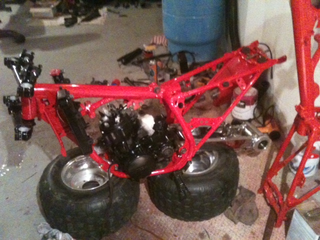

    heres my progress of the rebuild of my act 500r. my main question is exhaust. it looks as if the cr 500 gnarly pipe with fit right it with no mods. is this true? do you guys usually use cr500 exhaust with atc silencer? also whats the best way to do the cooling lines. i would like red hoses but i probably have to buy a couple kits to piece together. any input would be appreciated. or if you have any parts for me let me know. ill keep updating as build goes on. Click image for larger version.

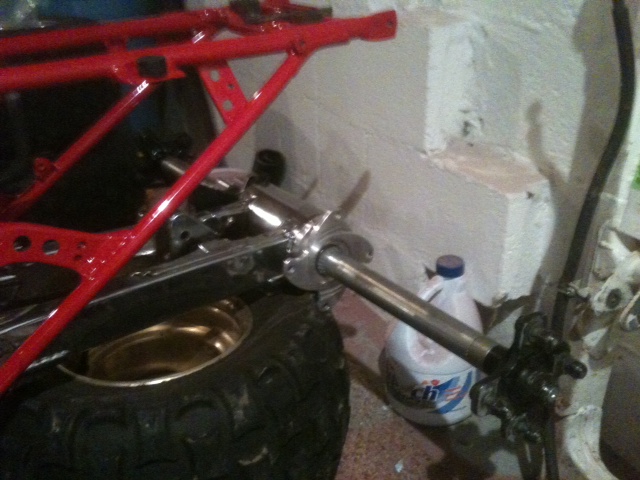

    got the dura blue today test fitted that and put a wheel on to see how it all fits up. heres some pics

    Is it just a stock frame?

    no a dead give away is the head mount when u use the stock frame u have to cut the head mount shorter. this frame has 500 basket in it but it looks real close to stock

    no mr clean yours is done similar to mine with a cr500 basket welded in. the question was is mine the stock frame? which is no its not it has the cr500 lower basket welded in. if u use stock frame u have to cut the cr500 head mount shorter plus do something were the down tube y's it wont clear exhaust.
