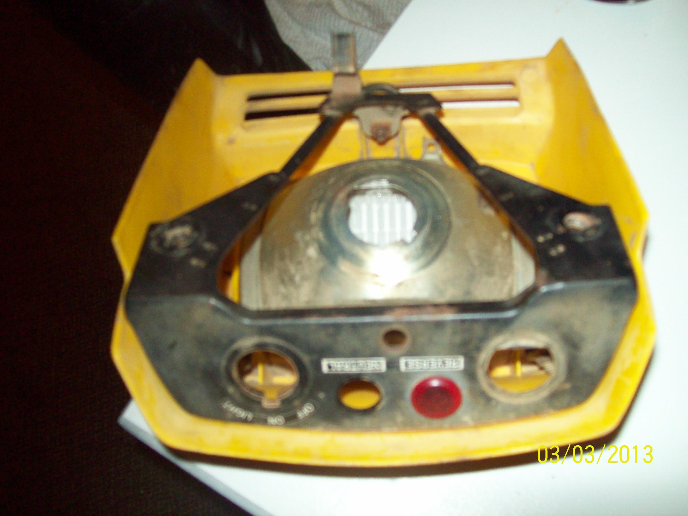

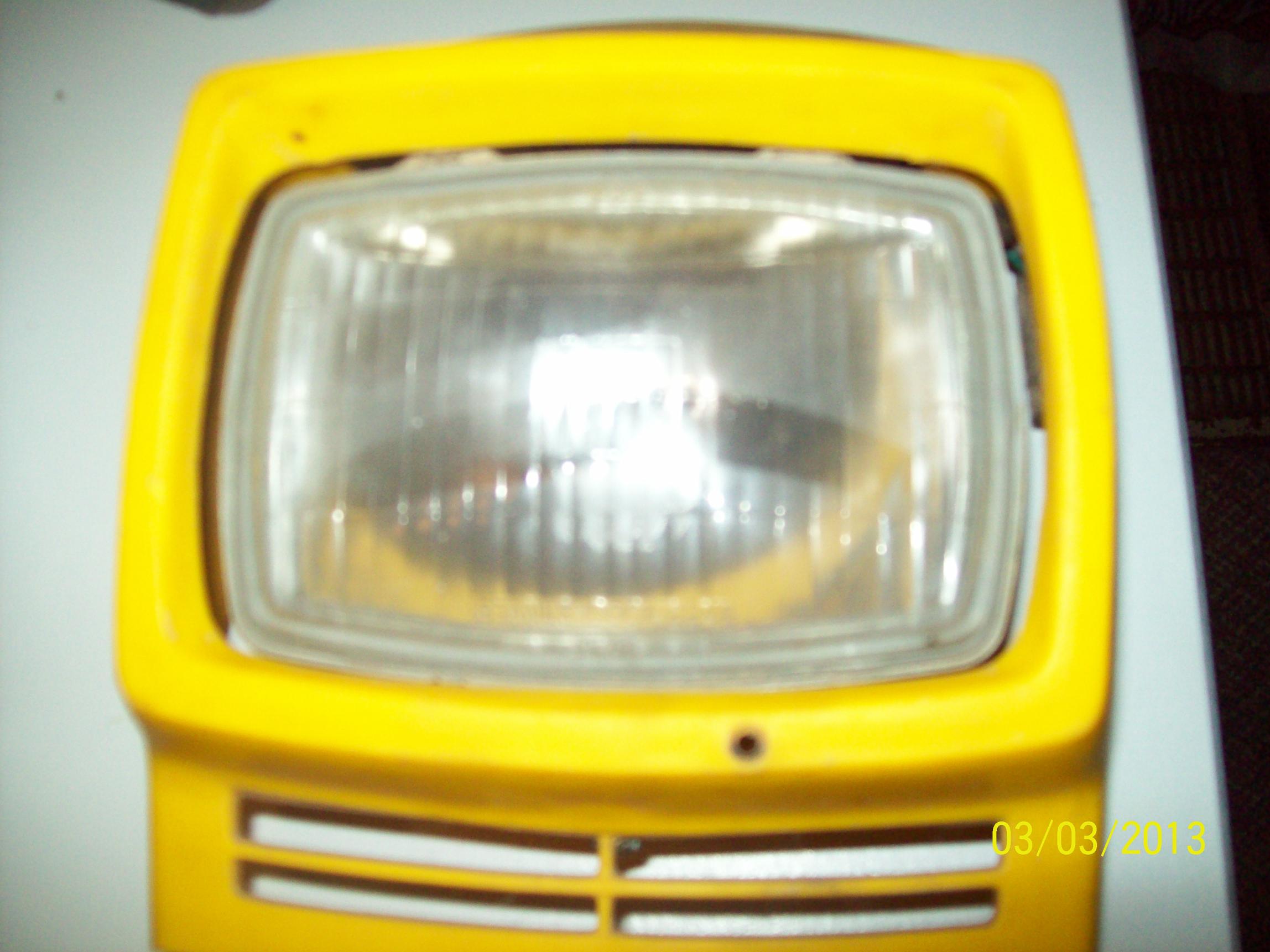

    there is only one problem with your jeep light if the wattage and amperage is to high you will burn out the lighting coil in your stator. I do have a ytm 200 headlight shell and glass, no bulb, but it would save you from burning up the lighting coil. 25$, plus shipping and it's your it also has the mounting bracket as well, plus the neutral light. Also the battery on a ytm only runs the starter all the lights run off of the lighting coil per stock wiring.Click image for larger version.
ID:	164274Click image for larger version.
ID:	164275Click image for larger version.
ID:	164276 here's some pics for you
