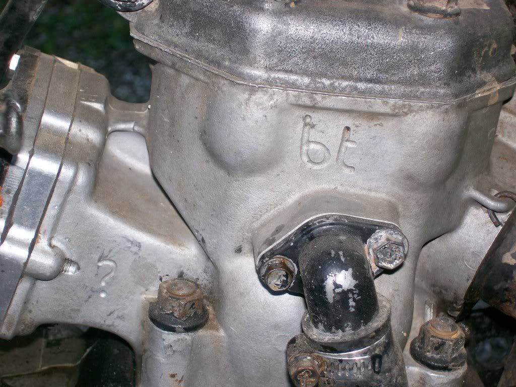

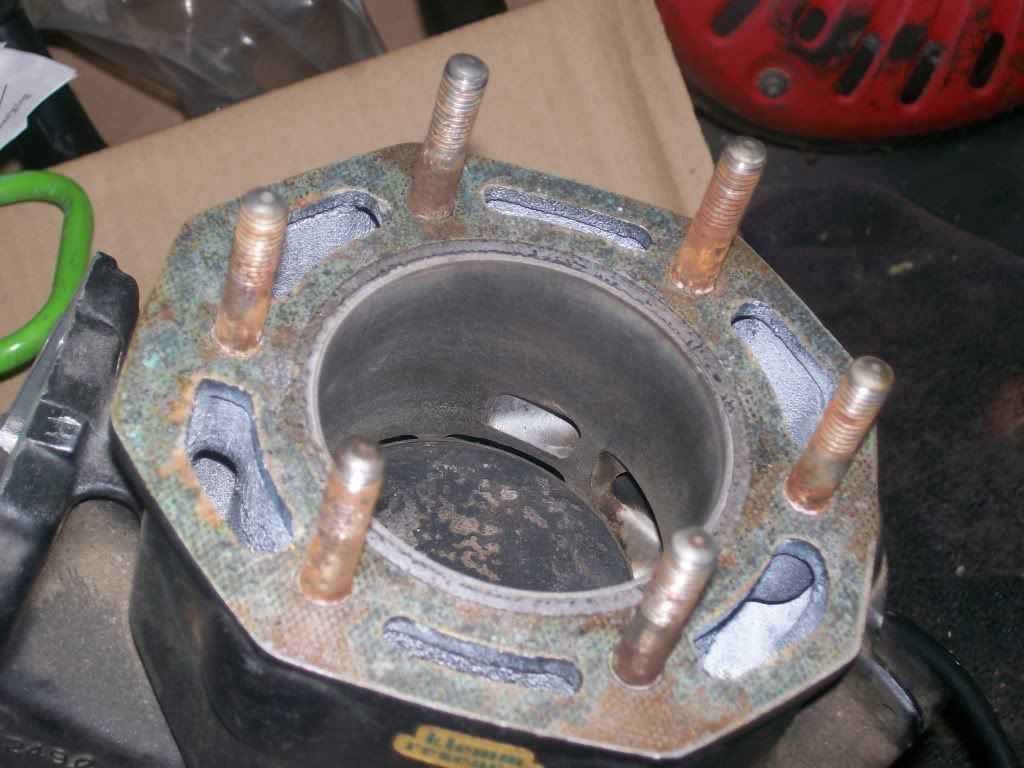

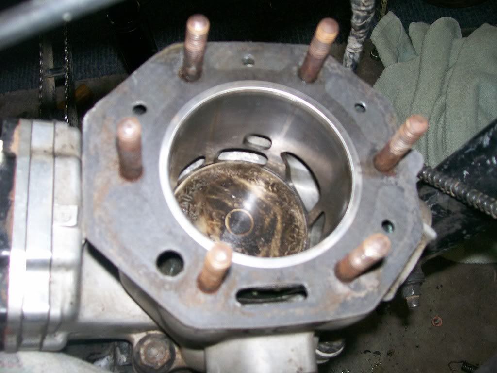

    I feel the exact opposite of Fabiodriven.. I've ridden a lot of different Tecate's. KXT or KX cylinder, ported vs not ported, even a 200cc Selvy's Tecate.. My Klemm Research ported KX cylinder with a 41mm Mikuni flatslide did everything I asked it to for 26 years on the same bore. When I traded it it still had 180 lbs of compression. If I ever own another Tecate it will have a KX cylinder that was ported by harry Klemm on it.. The power is mostly mid top but it just pulls and pulls like a freighttrain.. Everyone that rides it says the same thing. If you decide to go with the KX cylinder, send Harry Klemm an e-mail.. The guy makes magic happen with these cylinders..
    I also owned a KX cylinder that was hogged out by Bob Troxell of Wichita, KS back in the 80's, it had a motoplat ignition and I put my 41mm flatslide on it and it was like trying to ride a bucking bronco.. front wheel up in all gears.. When it hit the powerband just make sure nothing was in front of you it just moved out.. I got a hold of Bob Troxell who ported it and he still had the paperwork on the portjob and who it was for. It was used for flat track around the mid west and did pretty good from what he said.. Most porters number the jug under the intake.

    Klemm cylinder
    Troxell cylinder
    Bob Troxell said he puts the "?" on the side of the intake just to keep them guessing.. lol
