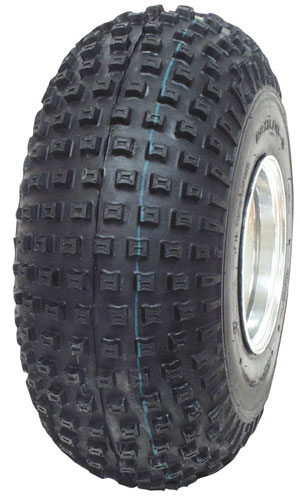

    iv always used knobby tires on front, worked well for me the little knobs work better

    Quote Originally Posted by newfiebullet View Post
    The turf buster worked well till I widened it, just the change in its width from the wider rims was enough to start it pushing the front, but I am pleased to say that I took it out with the swampers, and it is pushing alot less and you can feel the increase in power from them being lighter way more than I figured. Even pulling my lawn cart with 15 gallons of water it moved around better than with the claws on it and nothing trailing!!! pondering a 25x9.5-12 on the front to match the rears if I can find a good deal on them.
