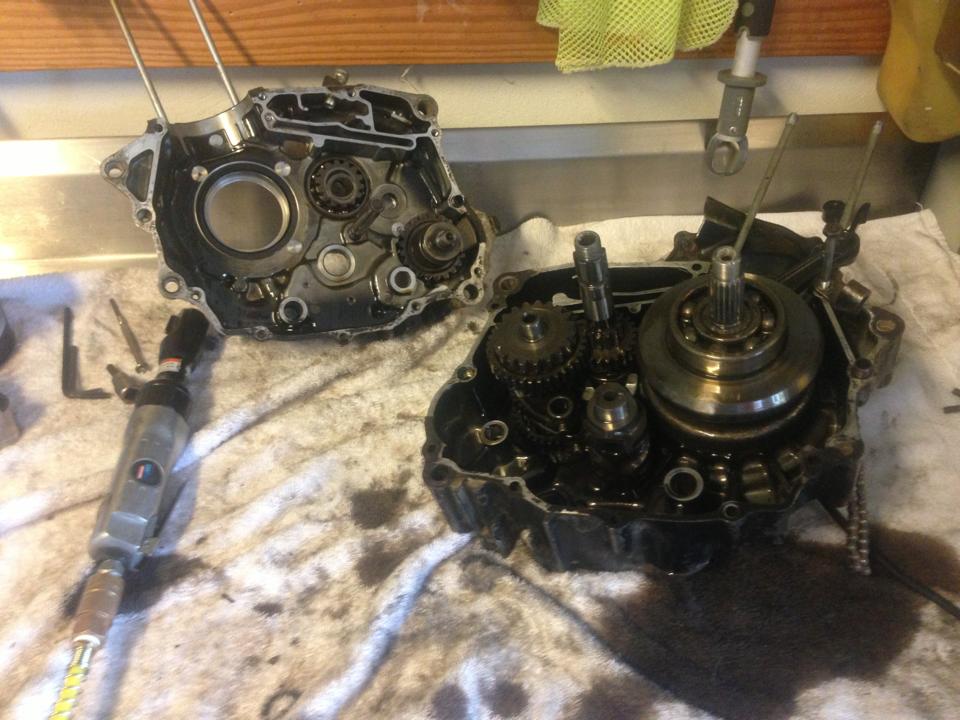

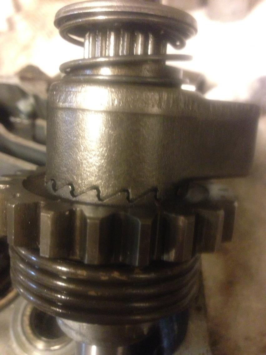

    im in the process of going through a 200x i got for free from a friend of mine. I got the cases split and the motor sitting on my bench. It was having the kickstart slipping issue and I read through quite a few threads on this site about how to fix it, so i got started...
    Of course, I have a list of questions already, but I'll start with:
    1. Where can i get the two springs for the kick starter? I already undercut the gears as per the other kickstart threads on here.
    2. Does anyone have a service manual in pdf format they would send me? I tried following a few links online but couldn't find one that worked

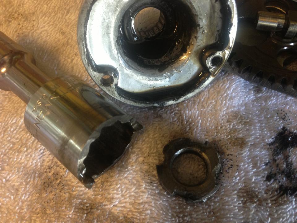

    I came across this site while googling kick start info. its pretty awesome.
    i even got the idea for the socket tool for the oil pump from here.. excellent...

    If you are running a stock compression ratio, then your back-cut should be OK. If you are upping the compression ratio, then I would suggest new kicker gears. Shortline10 (a member on this site) should have what you are looking for. I would send him a PM. As far as a manual, go to Kb0nly (member on this site) profile page. He has a link within his signature that will take you to the 200x manual that you need.

    hi guys... what do u guys mean by ( back cut ) or under cut the gears ?
    Feb 2013
    85
    200xking, basically, it means cutting the teeth with a sharper/deeper angle so they grab better. i'm no mechanical engineer, so, take my advice with a grain of salt.
