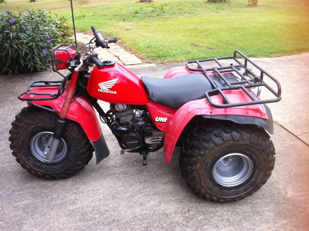

    Okay, I do know I should search the forum first before asking for help and I have done so. I have scoured all over the different posts and none of them have what I am experiencing. Here it is.
    I just rebuilt this trike last year. A fresh top end rebuild and some elbow grease to get it looking pretty and it was at 90% done. It was rideable so I rode it. I put a fresh battery in it and it worked great. Towards the end of the summer, the battery seemed like it was losing its charge and wouldn't start the trike with the starter. After I rode it a bit, it seemed like it would charge and would then crank with the starter. When I got the machine out today to start it the first time this year, it again would not start on the button. I wasn't surprised because of what had been happening last year. So, I decided I was going to charge the battery. I hooked it up to the charger, set it to 2 amps, and after 90 seconds it said fully charged... So, I put it back in the trike and I heard a clicking coming from where the starter solenoid is. After a couple of more tries, the clicking stopped and now there is just a faint noise that occurs when the button is released (still coming from the same region). The neutral light will dim when the button is pushed so I know it is drawing current. Signs point to the solenoid being bad. I got out the digital multimeter and tested the starter when the button was being pressed and it is getting no power. This sounds textbook except...
    The trike will run, I pull it and it starts fine. However, when I flip on the headlight, the neutral light goes completely dim. There is also about a 1.5 second delay from flipping the switch until the light coming on. I know a little bit of dimming will occur on the neutral light, but this seems extreme. I am wondering if I have two separate problems here. I know the '84 200es BRs are notorious for wacky electrical issues and I was hoping one wouldn't find mine, but this is what is going on. I know my battery charger is still good and I do believe the battery is charged. If it is the starter solenoid, okay, I can fix that. But, if something else is going on to cause the weirdness with the neutral light, I'm at a loss. I wanted to post this to see if any one thinks the two are related. Thanks!
