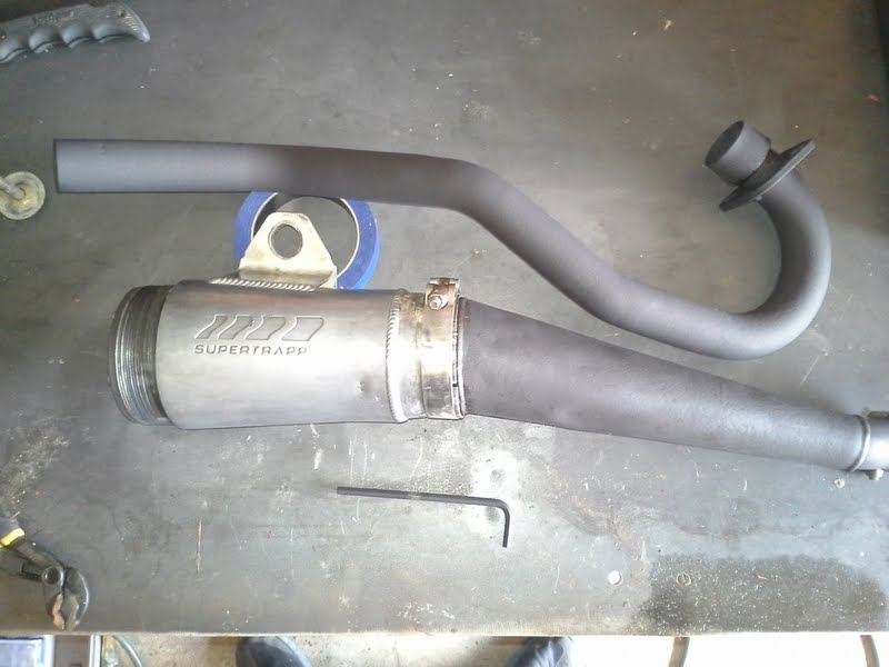

    here is an update put alot of the better parts on the 1985 200x and swaped the engine wire harness fenders seat grab bar waiting for the jets to come in and restored the suppertrap with hih temp 2000 degree header paint

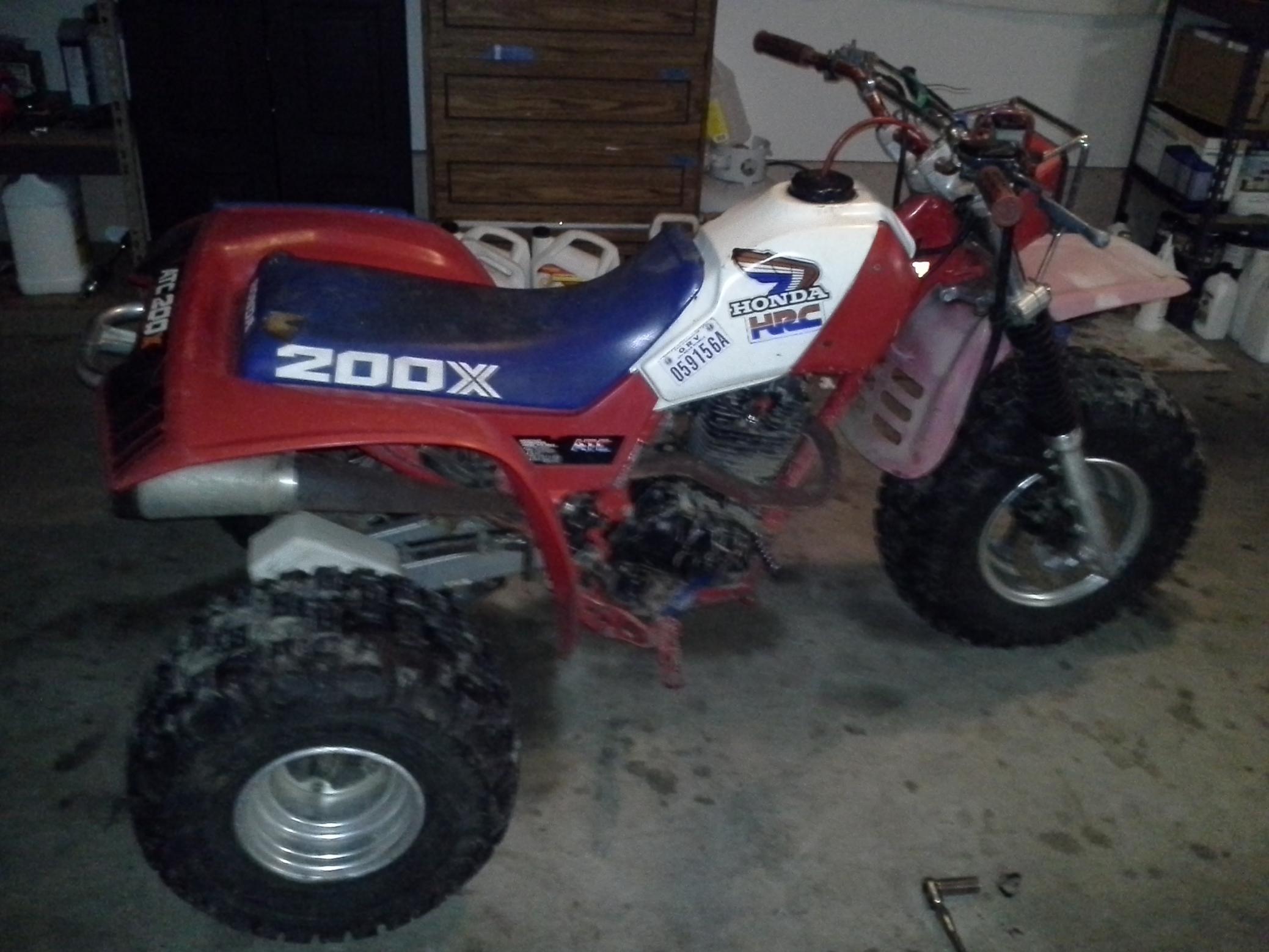

    here is a pic of it runs strong and everything works great
