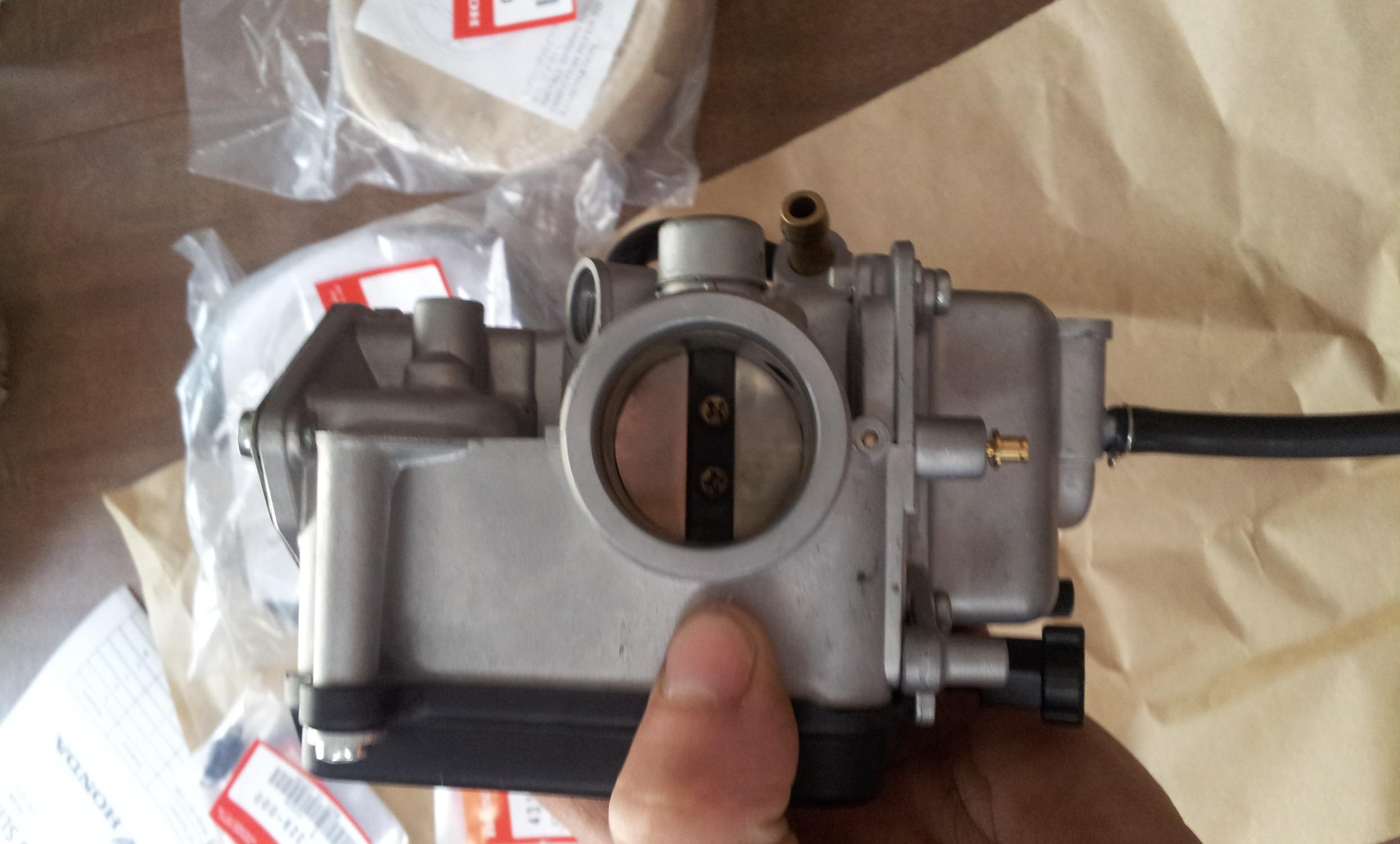

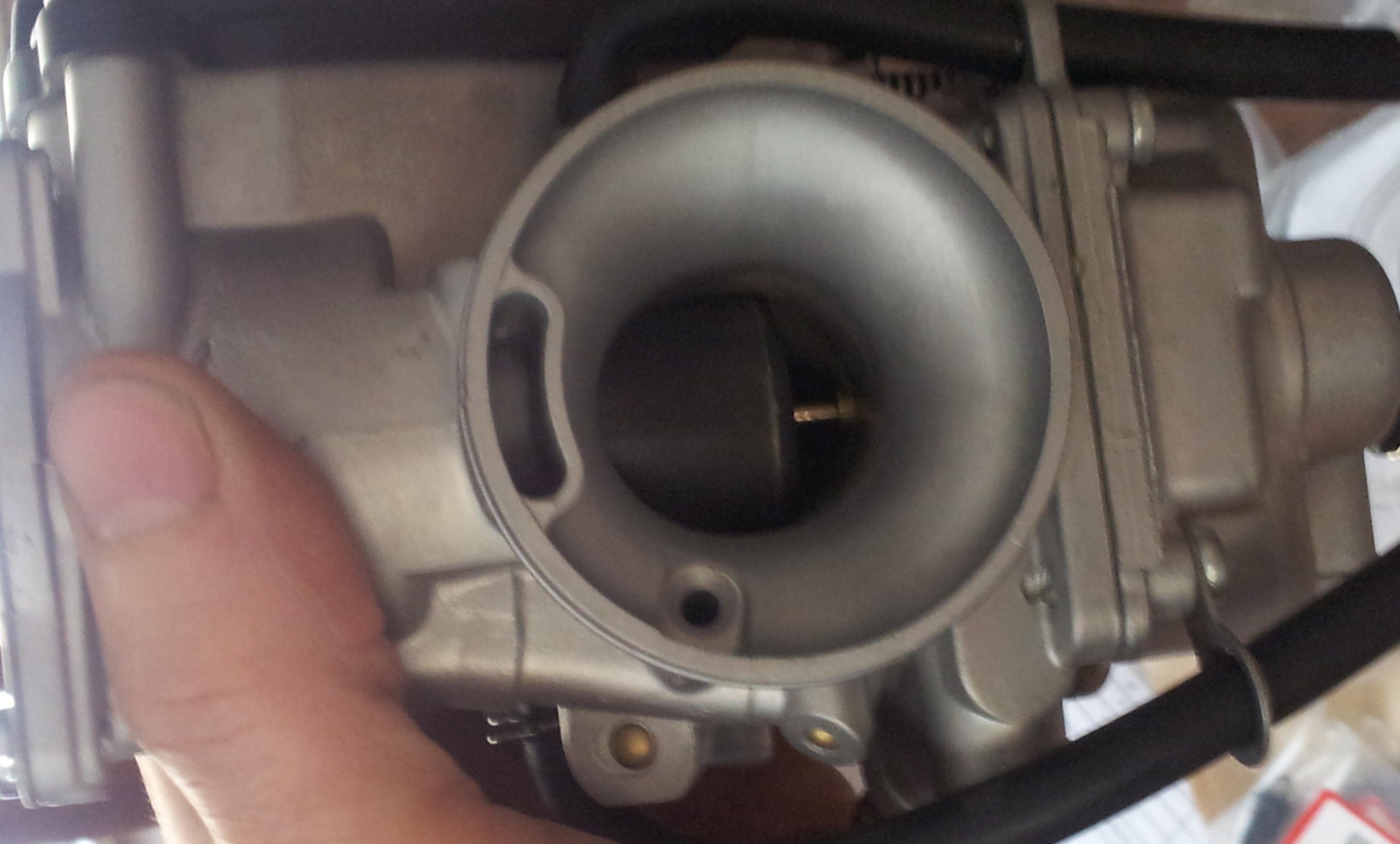

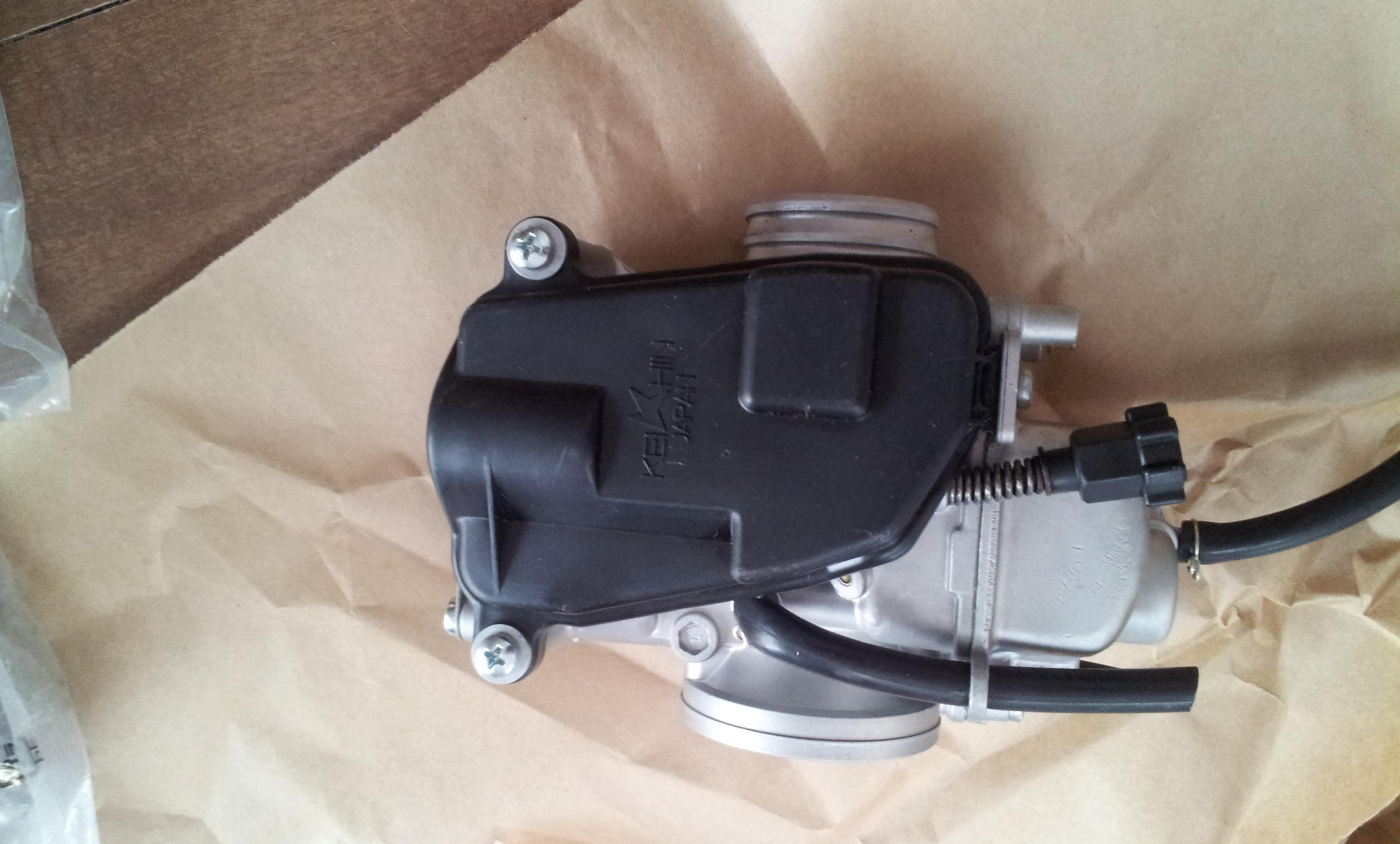

    SO my friendly mailman dropped me two boxes today. This first contained a beautifully rebuilt carb from flyingw her on the boards. I can't say enough how great this thing looks! I was able to install it today, but, unfortunately I didn't have an inline filter to install. I am certain this thing will not be as good as factory Honda, but, in fact better! Ok, the other box contained both front and rear shoes, one way bearing spare brake springs and misc hardware, all of which are oem Honda parts! Things will really be coming together soon!
