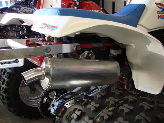

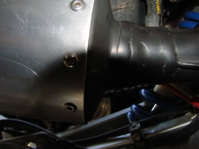

    lots of cans will bolt up to the frame, but you have to use the stock pipe works or that of the fore mentioned 400... what were you looking to do with it?
    here is just one example ... it was built by Kasey for me a few years back.
