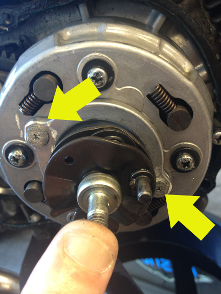

    I'm chiming in because I'm searching for the pieces you guys are speaking of. I've taken off the left side cover where the clutch is housed. Is this the side to be working on? Also, I noticed strange wear on some phillips head screws...

    Quote Originally Posted by jeepvolks View Post
    as I recall, I had the same sick feeling when I took mine apart.
    What in the world was loose and grinding against those p. head screws.?
    I just buttoned mine back up awaiting a thread like this one but mine looks the same.
    Those screws look as if they came loose and wore on something. And that is never a good thing. Look at your side cover and all other parts for wear marks.

    I got it all apart and the lever was both bent and a little split; probably should have taken a photo. Anyway, I ran up to work and welded it back (just enough to make it sturdy and put everything back together. Not sure why, but those screws that were shaved looked like button heads. There were holes countersunk into the piece they secured so I just bought some that had the matching counter sunk heads. Rides and shifts great! No missing gears, popping out of gear or hunting for neutral. Feels like there might be
    just a tad too much tension on the lever so I'll order a new one to put in there for good measure. Thanks to all and I appreciate you sharing your knowledge
