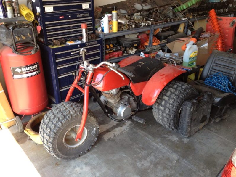

    A little bit of bummer news.....I stripped the fuel tank today, only to find bondo, Ughhhh! The top has a few dents on top, but at least there's no rust, so I decided to keep the dents for character, at least for now; someday down the road I'll get it fixed properly. I hit it with the Krylon Fusion Red Pepper and it looks great. I also installed the new rope and grip for the starter, the spring that holds the seat latch in place, the NOS hand grips and painted the metal end caps, the NOS rubber grommets that hold the headlight frames in place and installed the wiring harness, which is in immaculate condition, compared to the old one. Last thing installed was the new sprockets and chain, along with the aluminum chain guard, which was missing.
    Here's a pic.
