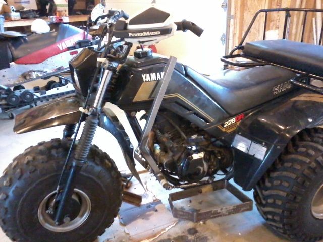

    We have progress!

    This is gonna be very cool to watch! I love the foot mounts. Jockey shift is sweet too. This thing is gonna be awesome!
    Only problem I see is if you have to go down a hill and take a turn at the same time, that thing can tip over. Ive done it a few times on my 225dx. I mean.. If you keep on the throttle, and whip the rear end out, you can avoid it. I have had to put my foot down to keep it from going over a few times. So be careful.

    Wow, wasn't excepting a linkage setup that heavy dusty, it shalt never break lol.
    Just wondering, are you going to add some sort of strap for your feet, or do you think the high sides of the foot pegs will be enough? I guess it really depends how fast and hard your planning on riding.
    Kind of an interesting idea. I'm sure your not the only person in a wheelchair that wants to ride atvs, so I bet there might be a small market for custom fitted kits to make atvs 100% hand controlled.

    It looks cool now that it's done but it was a PAIN IN THE --- to get it figured out. No moving on to the carb and lighting. I also need a new front light plastic if anyone has one. also looking for a seat in any condition. I just need the pan. Is there anyone that can tell me the carb settings? I can get it back together, but im not sure what everythign needs to be set at (jets, air screws, etc).
