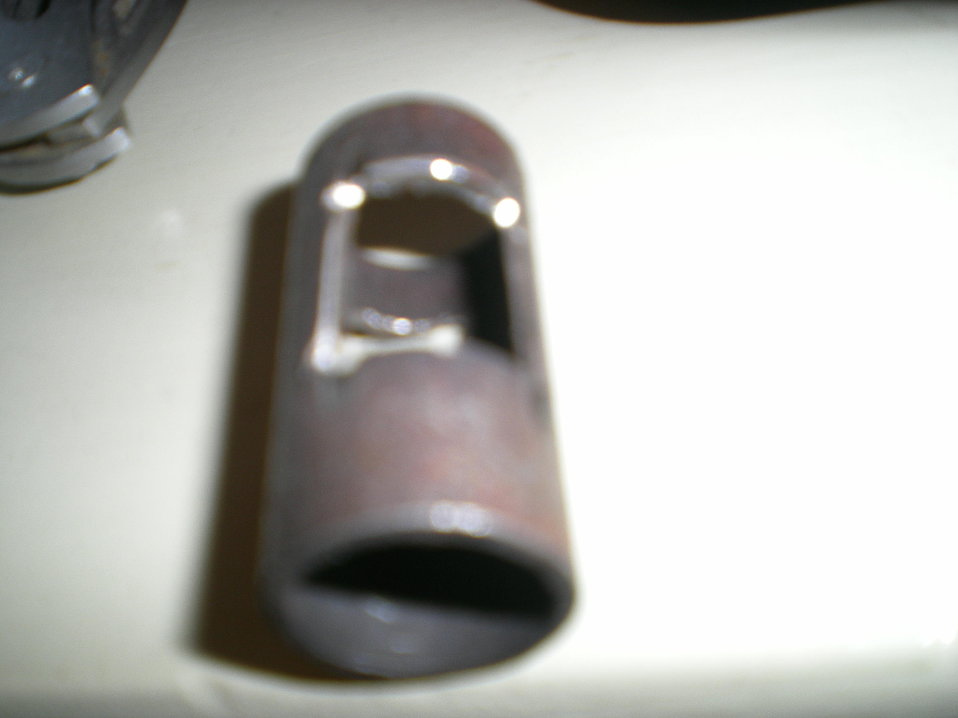

    it would be nice to have someone with videos on here to show how its done. ive been thinking about making some myself but just do not have the time. like i said in one of your other posts i have seen that engine failure alot and i hope you have checked your other bikes as well. along with what you are doing already check the chain guides for wear and check that the self-tensioner works properly. do you have the tool to disassemble the valves because it is easily made and i can post some pics of mine if you dont have it yet.

    Yeh could you post some pictures of that tool?

    finally found the valve spring tool
    sorry it took me so long I had a hard time finding the little bugger. this is actually the first one I made and quit using cause I made a longer one with bigger windows. so make it as long as you can for the size c-clamp you have. and larger tube is better too. I had no choice with this cause I was using it on my 110/125's but it still worked on 250s just not as much room to get keepers out. use solid base of c-clamp against valve and this between screw side and retainer. compress the valve spring and use a magnetized screwdriver or pick to get keepers our good luck

    the newer one I made only had about 1/4" of metal at bottom and between windows which made it a lot easier to get at keepers. and this only needs to be made from 1/8 wall tubing but thicker wall plumbing pipe will work fine too. I used a dremel with cutoff wheel to cut windows cause it is easier to control than large angle grinder
