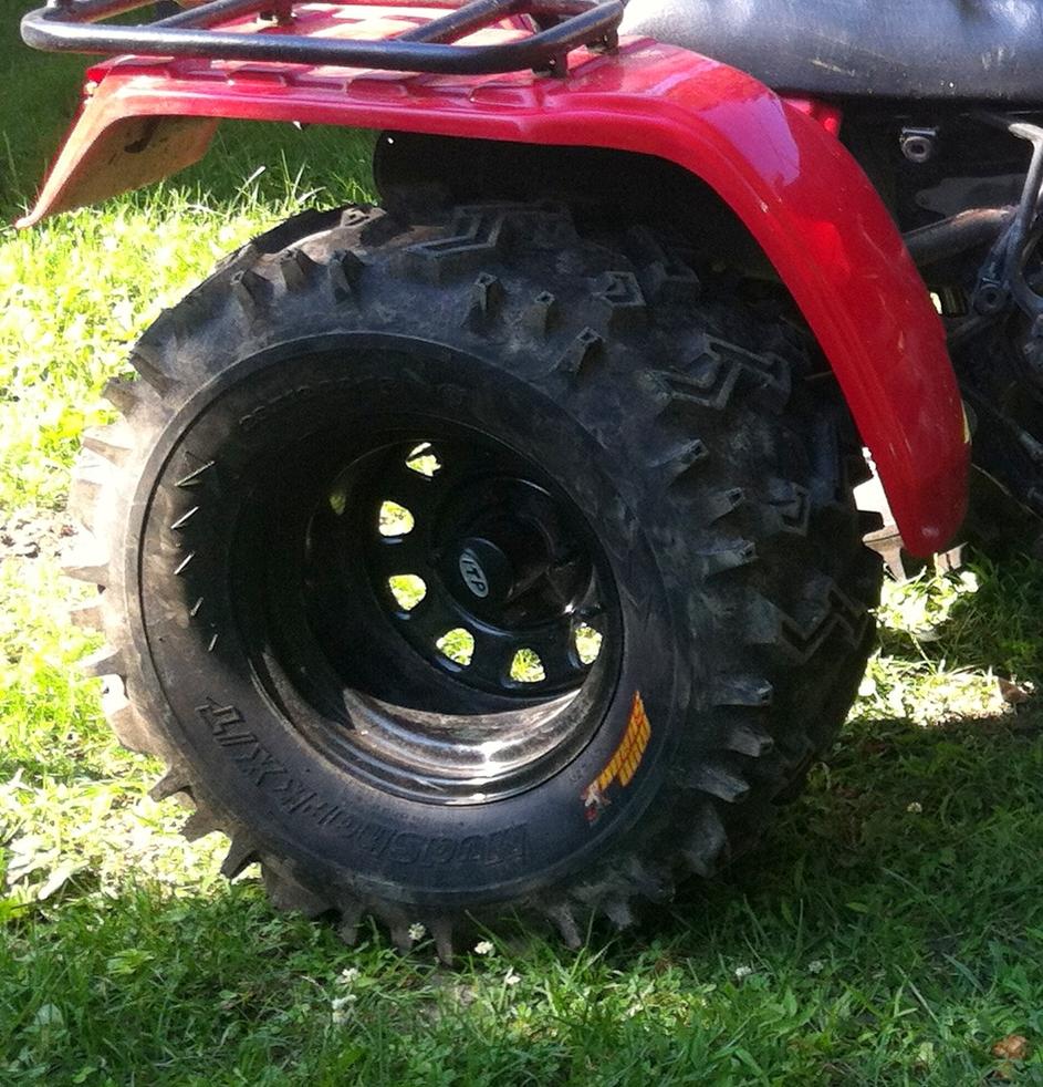

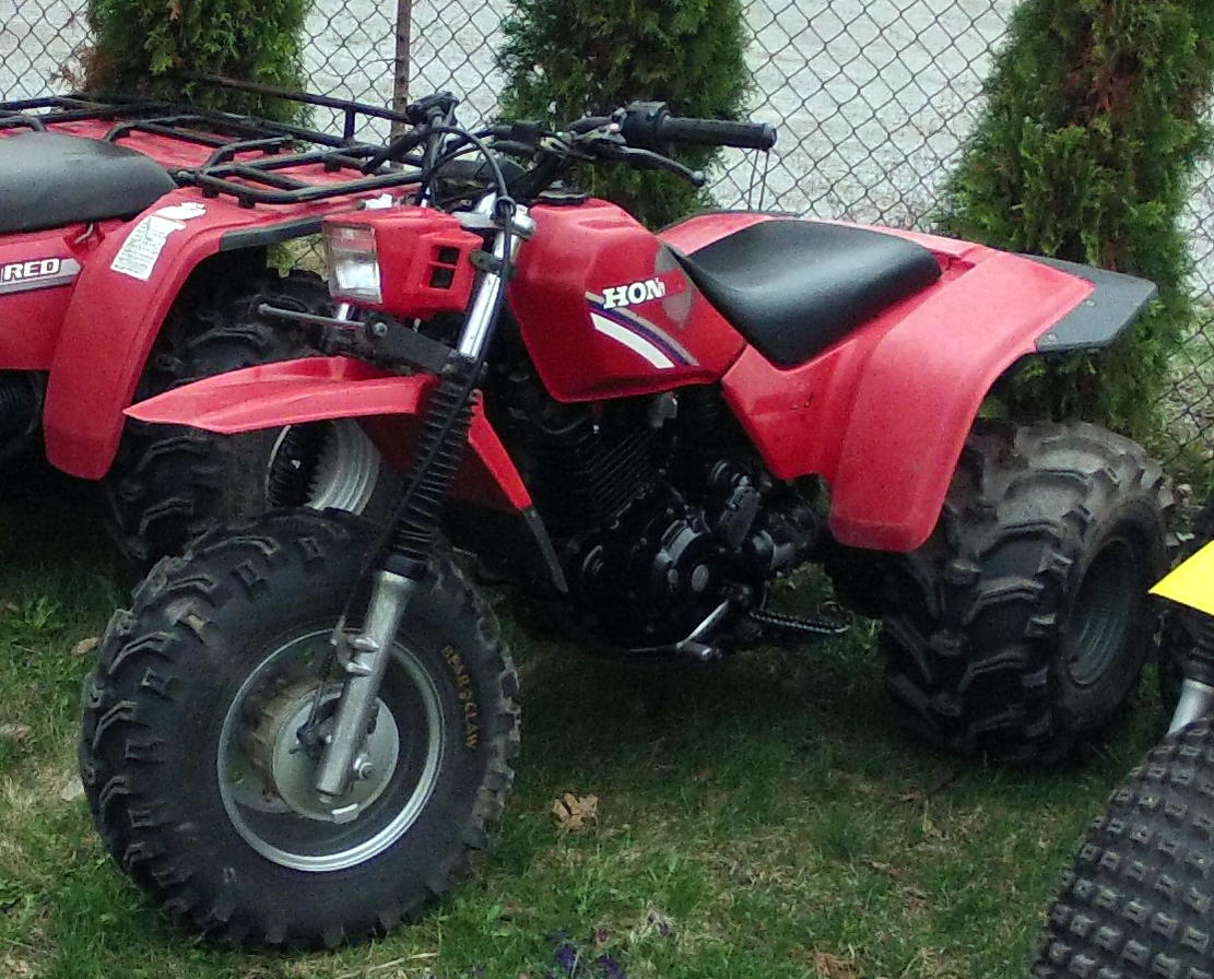

    Maybe think about something like this..
    It will definitely improve your handling, mudding and hill climbing!! Won't stop your azz from tightening on those crazy cross grade hills..but it will help it immensely!

    wow! i always wondered how well does the stock motor pull those giant tires? do you prefer a stock motor es on the trail or a bored performance version?

    Never had any performance enhancements on mine..stock machine definitely has no problem pulling these tires and my 240lb azz around!
    These tires are only 26", just one inch over stock diameter so they have little effect on ratio..guys have gone into 28" and reported little or no problems.
    This setup I have is awesome..and the change to the steering is beautiful. Pretty much eliminates the steering slip issue trikes have.
    My brother just bought a 250ES (dman) and we will be applying the same changes to his trike..I like to experiment with wheel setups and have found some winning combinations for replacements for the old OEM.
    I can send you the details so you can order a set for yourself..you can do a full set of tires/rims/caps/nuts and stay in or around $400.

    I would deffinately be interested in that u can see how a flatter narrower track on the front would help. I'm due for a front tire at least. I think I've got 7 or 8 plugs in it. The code on it reads the 40 th week of 1984 so its lives its life!
    Can you get all that from this site?

    Try this...
    4/110 ITP Steel Wheel 12x7 2.0 + 5.0 Silver - 1986 Honda ATC 350X (Rear)
    Part # 1087260011
    $39.99
    Kenda Bear Claw ATV Tire 26x9-12
    Part# 1054490013
    $72.99
    Tusk Tapered Lug Nut 10mm x 1.25mm Thread Pitch w/ 14mm Head Chrome 4-Pack
    Part# 1287110002
    $2.99
    www.rockymountainatv.com
    Free shipping over $100..don't forget to tell them to load the tire as a 'right side wheel' to make sure the tread is pointing in the correct direction.
    This rim will bolt directly onto the BR front end without spacers and the thinner front wheel will make your steering track better..have fun.
    It is exactly as you saw on my machine, but my rim is black..it also comes in silver. Oh yeah best order a 4 pack of tapered wheel nuts too..
    And no, I don't work for Rocky Mountain..I just like their stuff!
