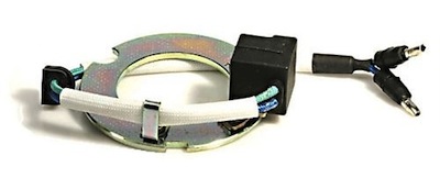

    yeah that happens. seen that on a 110 and recently on my 200x. take a good look at the cam journal on the cylinder head. if the lobes were that bad chances are the journal is bad too. that is what actually causes you to loose spark. the journal wears and the cam, and the spark advancer and magnet move farther and farther away from the pickup coil. eventually it moves far enough away that the magnet becomes too weak to be read by the pickup coil. there is a certain amount of gap (can find measurement in service manual) that you want but too much causes you too loose spark. there are 2 sets of screws on the pickup coil mounting plate. 1 moves the whole plate which is what allows you to change ignition timing and the 2nd adjust the height of the pickup coil. if you can move the pickup coil all the way down (closer to camshaft) and still cant get the proper gap, you need a new head.

    Quote Originally Posted by trike savior View Post
    Is this the same coil you're talking about? I didn't have much luck trying to use the second set of screws to move the head up and down - there's not any slack for the head to move around on - makes sense though.

    My loss of spark was from a bad stator exciter coil - down in the flywheel. It tested bad when I got it home and started ripping things apart. I ended up replacing the generator coil, pickup coil and ignition coil anyway, found some decently priced replacements on eBay - now I have a few working backups =D
