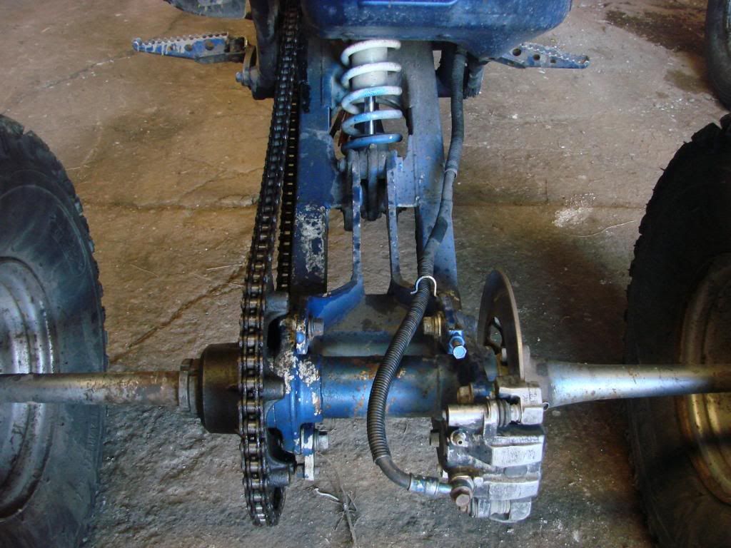

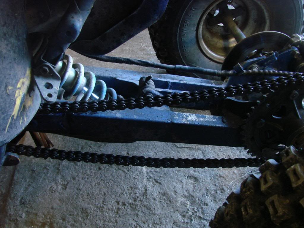

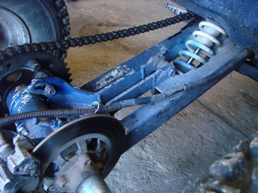

    So, get that yamaha running right?? still want to see some good pics of that swingarm

    work then sleep and repeat lol, i gotta get up early and fax my pay roll in i'll get some pics then.

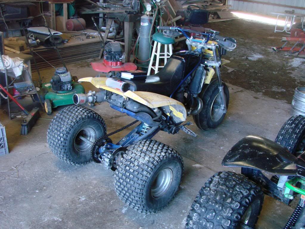

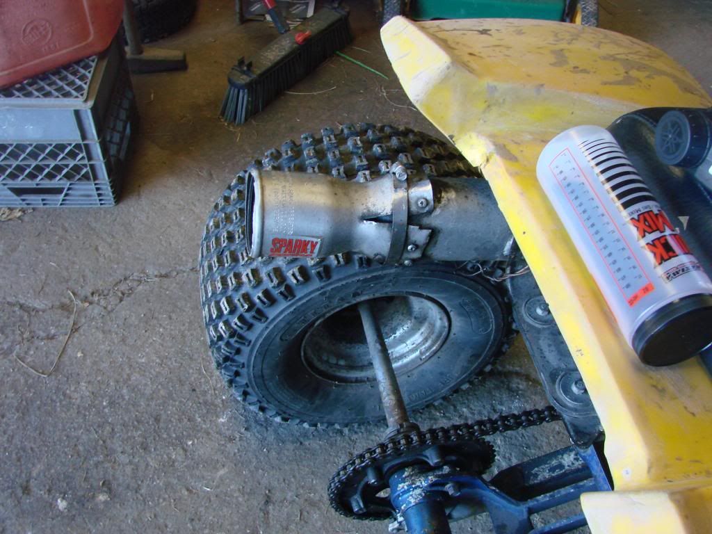

    ok yea my ignition is missing lol replace by a toggle, uh i'll have to look and see if i can find any green or yellow wire's, i think i'm gonna take the bike to a local 2 stroke guy and have him check it out i took a ride around the 20 acres today barley hit 3rd gear cause its 2 wet and when i went to part it i noticed i was leaving a trail of gas lol and when i shut it down a tiny bit of coolant leaked out, my camera batteries died before i could get a video so the 1 i'm posting sounds like garbage gotta love cheap phone cameras lol

    and pictures i got before batteries died
    do i really need this?
