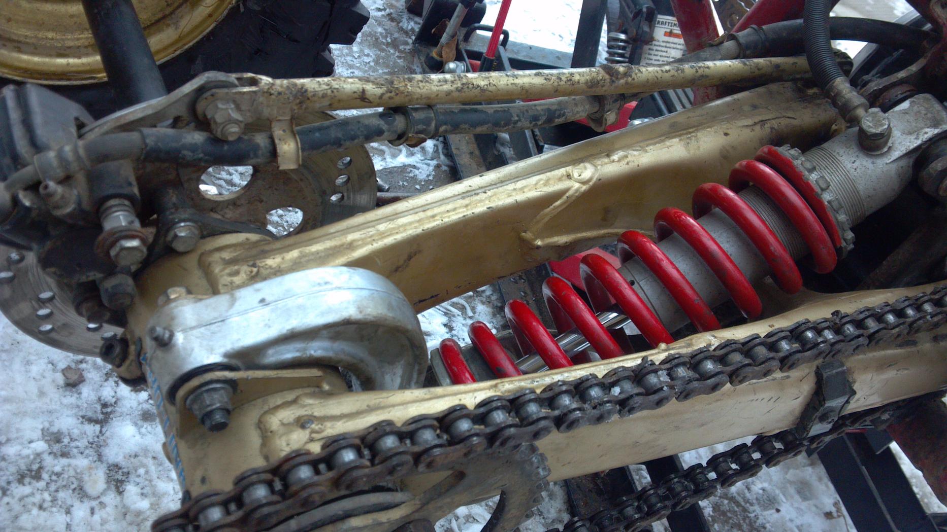

    Couple pics.This is 84 style.Click image for larger version.
ID:	166429 Click image for larger version.
    250r rules

    THANK YOU! That is awesome! One last thing I am confused about is the "cushion arm" coming off the lower part of the dram, how does that mount? If you tell me that it's not important, then bye-bye it goes. Hopefully that is the answer because it doesn't seem to "fit" anywhere. Thank you!

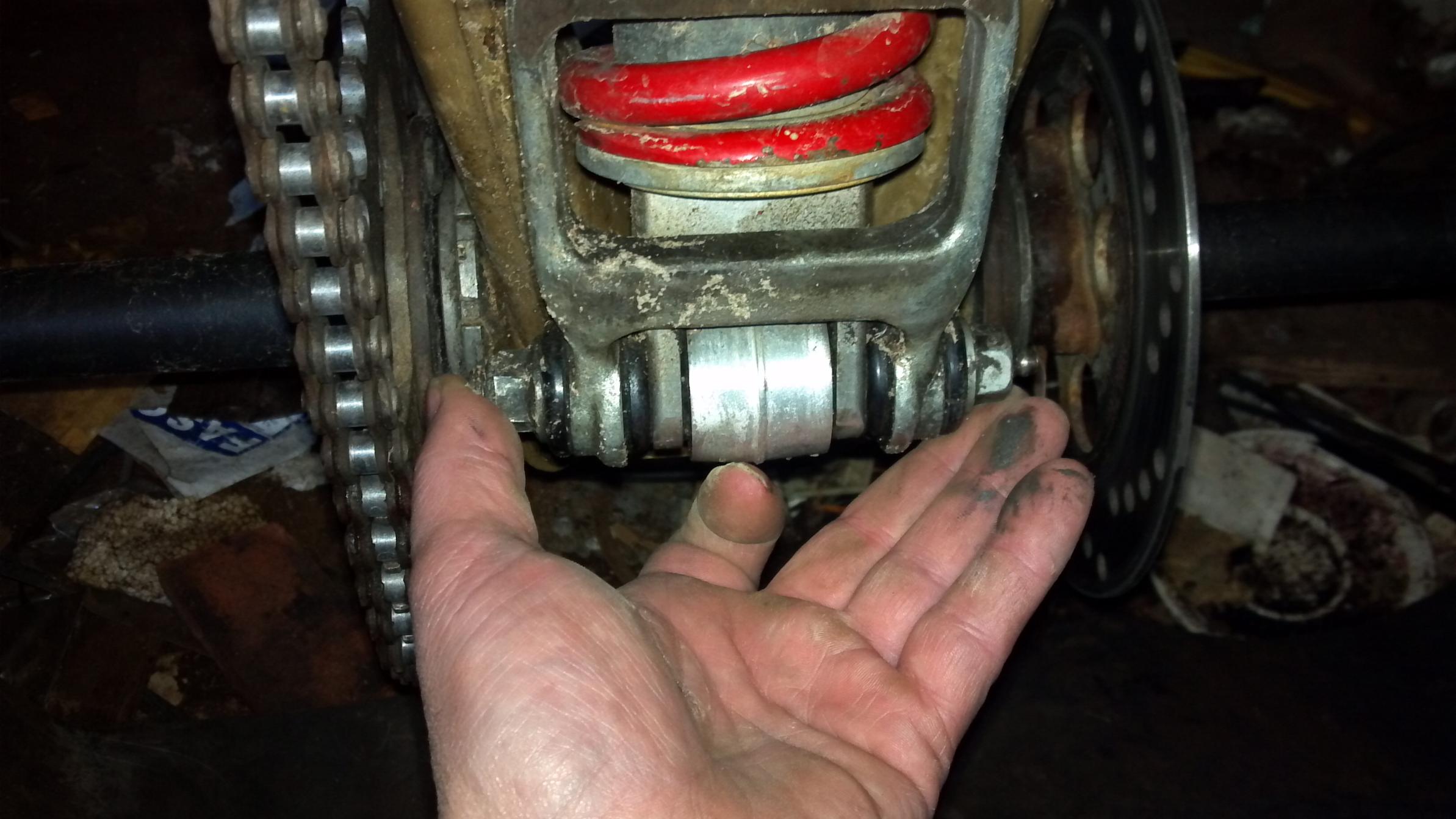

    Carthage NY 250r rules
    2,355
    The lower shock mount,lower dogbone and linkage all bolt together with one long bolt. Click image for larger version.

    That is absolutely perfect! Thank you! I will post pics soon, I am new to the forum and still figuring things out. The guy who had it before me did a horrible swing arm extension! Luckily it is all fixable with a ton of grinding and a little welding. Thank you for posting the pics for me! I will get the pics up soon.
