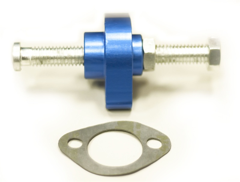

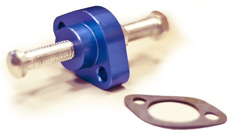

    Someone described someone had welded a bump on the end of the tensioner for that same purpose.
    There's also a manual adjustable tensioner that I posted about yesterday.
    Pretty much a threaded bolt with a locknut that can be positioned anywhere you want.
    Pretty spooky when they're out that far because they apparently WILL jump teeth
    if too sloppy.
    Guessing bent valves if it gets that bad.
    Sure are fun machines, eh?
    Have a great time and try to find a couple more.

    my question is how would you adjust it?...theres no way to feel if its too tight or too loose...
    Pacific NW
    4,255
    yeah, that's what concerns me.
    I guess they're sold as for racing so that killer decelleration, the chain won't be tempted to jump.
    They are listed as specific for the honda sx and es 250. but their
    tensioners 'step' out and won't get flung back in for the chain to jump
    in that situation, unlike simple spring or hydraulic pressure tensioners.
    Now if the original chain is loose and the stock tensioner isn't
    providing enough tension, it could jump anyway.
    Which brings us to this new tensioner for this worn out situation.
    I'm thinking it Could work for a little while as long as it's
    'owner operated' and no one overrevs it??
    Maybe there's instructions that say something like:
    "Set at TDC and torque tensioner to XXX inch pounds and then back off 1/4 turn",
    but that's just my guess.
