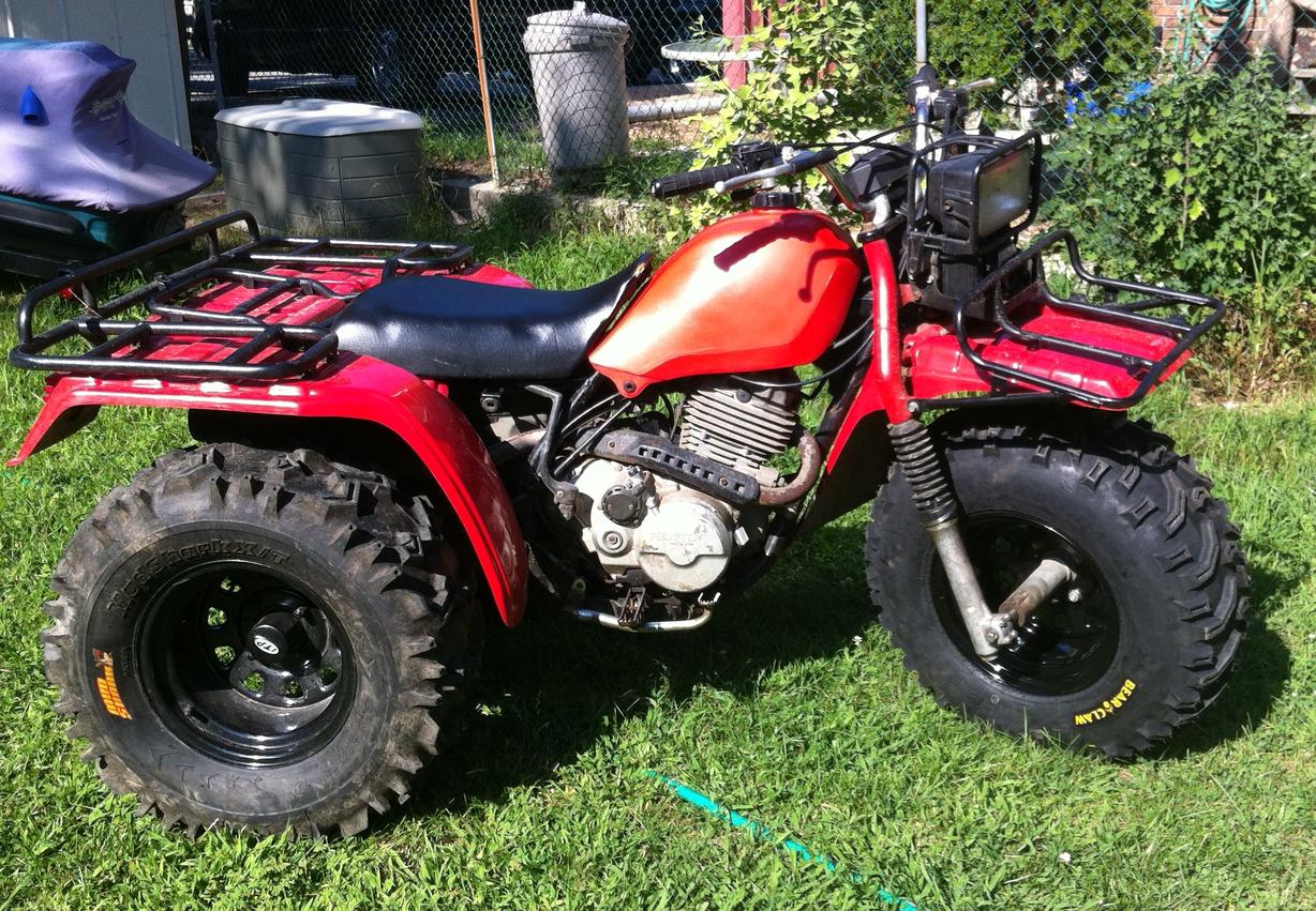

    The engines themselves are completely interchangeable in the two machines..my 85 250ES currently has an 87 250SX power plant.

    doug thats a beautifull big red there, havnt seen many in that kind of shape and i like the black wheels on it too looks sharp all around! I usualy like the sportier trikes so normaly i would go with sx over the es models but if it looks like yours ill take it over sx lol!

    Right on your right that sx is pretty! Yea it does give some motivation when people acknowledge your work or finds! keep on it man bike looks great.....
