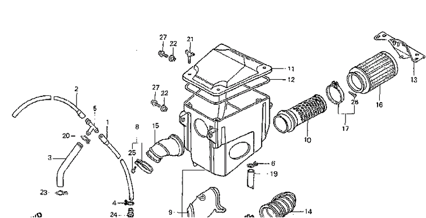

    Just got an '84 200ES Big Red, and bought a new air filter for it. I have all the parts according to the parts diagram:
Name:	Air Cleaner Parts Diagram.png
    But when I install the bracket on the rear of the rigid internal screen element, then insert the rigid element into the rubber boot/outlet of the airbox, I
    wind up about a half inch short: so the rear bracket doesn't contact the rear of the air box, and the rear bracket holes don't line up with the airbox cover bolts.
    Am I missing something?
    Thanks in advance.

    Either you have the wrong internal screen or the bracket is wrong... I forget which model it is but there is one i have in my parts box that is the right diameter for my 200ES but its not the right length.

    I agree with kb0nly, probably the wrong screen, I might have a spare as well. You could make an adapter to make it work as long as it seals up good, but fixing it right would be best.

    I was able to make it work by bending the bracket, and enlarging/slotting the holes where the bracket mounts to the airbox.
    Then the air filter is a little pushed in, so I created a "backing" for it with piece of plastic cut to fit. (I'll take a pic and post it.) Frankly, I think the filter or bracket
    should have backing there anyway.
