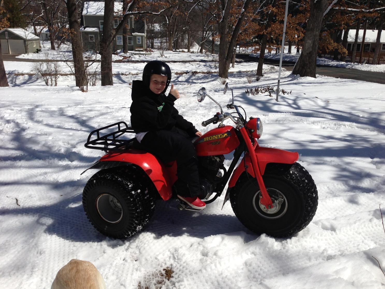

    Here are some pics.

    CLEAN MACHINE!
    look at that race face haha

    What a find! ! ! Treat her right, I have a soft spot, for the 185s...
    Congrats and have fun.

    That is not a 185S,it is a 185. And yes,,a very beautiful one at that. Welcome !
