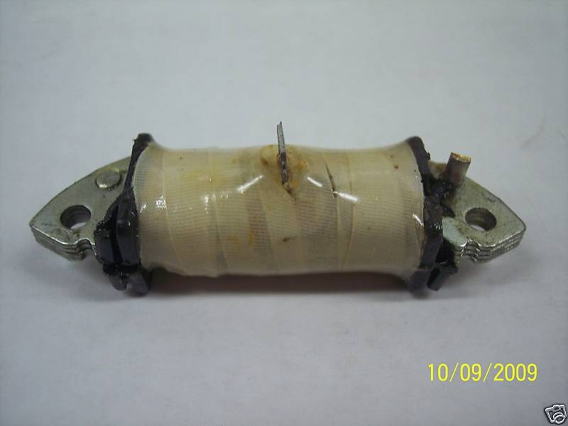

    I couldn't do the unplugged test of the source coil because my electric start isn't working -- and my meter can't keep up with the short burst of the pull start.
    So I ran into a problem installing the coil.
    Here's a pic of it:
    As you can see, the tab for the red/black wire is in the middle on this coil instead of at one end. I bent that tab over so it wouldn't contact the flywheel (not knowing how much clearance there is in there). Then figured if I could mount it so that tab is on the underside that would be even better. But that little tab on the right is in the way, keeping it from being able to mount flat. I figured it's metal, mounted to the base, it must be just another ground that's used in a different engine. So I grab it with a pair of pliers, and break it off. Turns out there was a tiny wire attached to it -- looks to be winding wire. I tried soldering the wire back to the base -- and some solder did stick -- but now I have no spark, I guess I need to order another one. (It gets expensive doing dumb things!)
    I see one that's listed to fit these: HONDA ATC 110 81-85 / 185 80-83 / 200 81-86. That should work, right? Is there enough room for that tab to not contact the flywheel?
