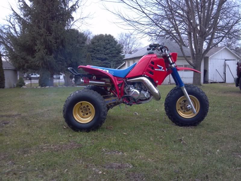

    I think I maybe had a 1/2 inch at the top with mine maybe an inch at the bottom of the tank.. It was close
