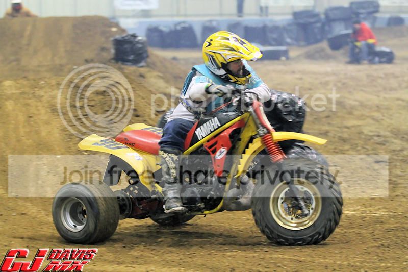

    Rittman, Ohio
    6,276
    Yellow and Red? Why not!

    Ya! Thats what Im talking about. It looks real cool I think!!
