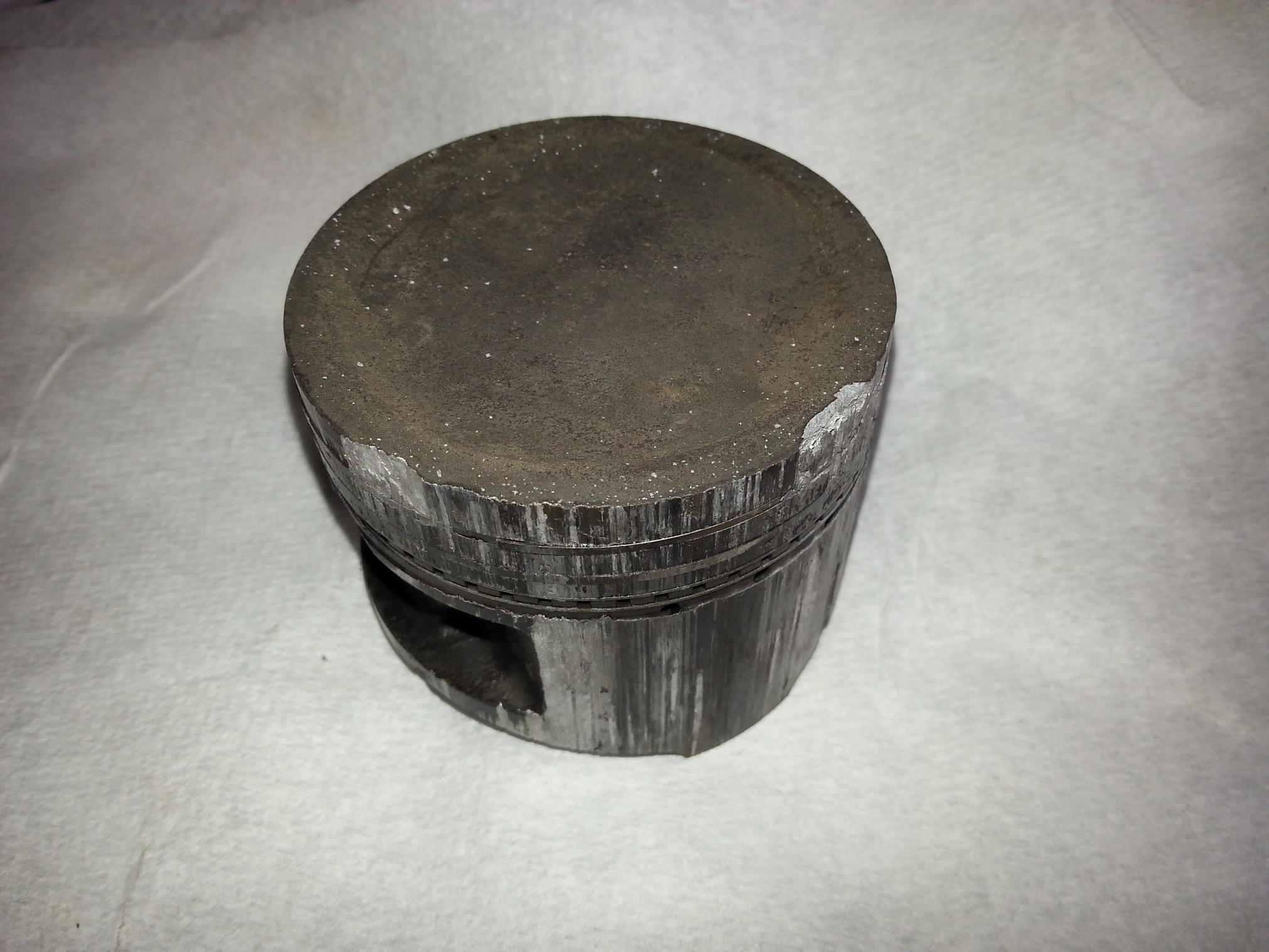

Having trouble removing the piston pin. Any suggestions???
Also, is it normal to have a little side play in your in your piston?
Thanks.
Having trouble removing the piston pin. Clips are off each side. Moves back and forth about 1/4". Any pointers??? Just didn't want to force it too much. Also, how much side play should there be in the piston?
Up and down play their should be none , side to side is ok . Tap the pin out it shouldn't take much effort .

If that pin don't come right out with little force tap it out but be careful not to scratch up the inside of the rod end with whatever you use to punch it, it shouldn't take much effort.
My cost estimate... $150-$200 depending on the condition of the cylinder, if you can get by with just a hone and a stock piston and rings and a top end gasket kit your more on the $100-$150 range, if the bore is scored up from the piston coming apart your going to have to bore and hone, either way you need a new piston and rings so the cost stays the same as far as gaskets and parts, its just whether or not you need a shop to do a bore and hone on it.
Also don't forget to rebuild the head, at least clean it and remove all the carbon buildup from it and the exhaust port, remove the valves and clean up the seats and lap them in if they measure up ok, main thing is replace those damn valve stem seals while you have it this far down, cause otherwise you will be doing it again later when they start leaking!! LOL
1984 Honda ATC200ES "Big Red"
1982 ATC200E "Hondie"
I've had a couple that were pretty stuck before..
I use a couple small pieces of wood between the piston and the jug pins to steady and support.
Then a 3/8 socket extension piece as a punch..a few taps with a. At this point you aren't too concerned about your piston and pin, they're already casualties..you just don't want to bend or damage your connecting rod..

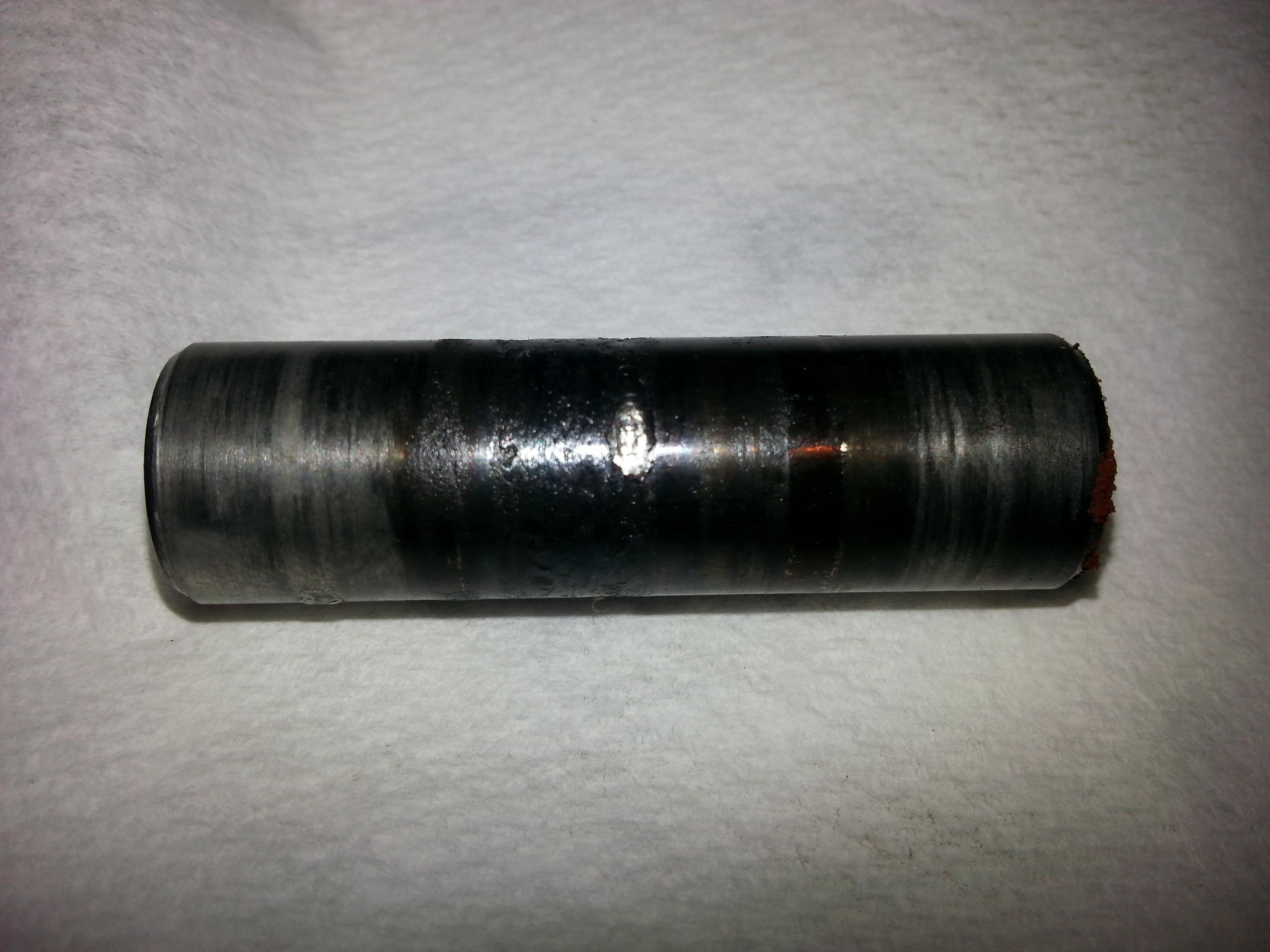

From the look of the pin, you may need a new rod.
Check it for missing chunks.
Maybe able to hone it smooth, but it may make it out of tolerance.
Did you run out of oil? Looks like it. Damage along with the cam.
Might also want to pull the right case and check the oil singer and oil pump for damage.
Ouch that looks like pretty major damage there, my guess would be a bore is in order. I agree with my1423, atlast pull the side cover off for the oil pump pickup and do some cleaning up.
If you do fix this engine and want to buy a piston kit ect, Rigid hone the cylinder prior to having it boarded or ordering a piston.
This will remove the chunks and make sure there are no deep gouges cracks in the sleeve.
Do not want to buy a piston then find out the sleeve is to far gone and you need to buy the next size up piston.
Probably ok but better safe then sorry.

Have them also check the cam and bearing sleeve. Might have to emry cloth the journal a bit.
The rod might clean up with emry as well.
Get it miced

It was not out of oil, but got VERY warm. I believe the aluminum would have come from the piston. Either way, it's a major. Thanks for everything so far. Just looking for a shop now to take it to.
