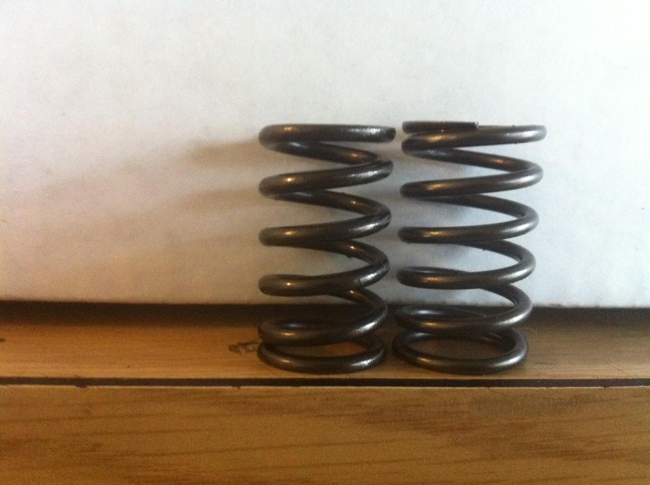

    Ok so I took the bike apart and found that the new springs were in fact undersized. They measured 33mm while the old springs measured 34mm. Needless to say I will be reinstalling the old springs as suggested above and give that a shot. Also took some measurements of the drum and clutch shoes and both were within spec.

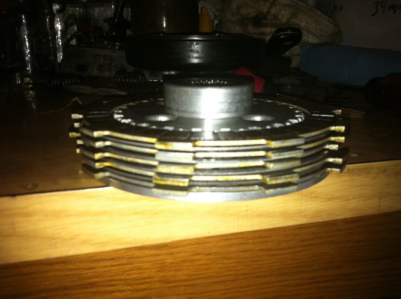

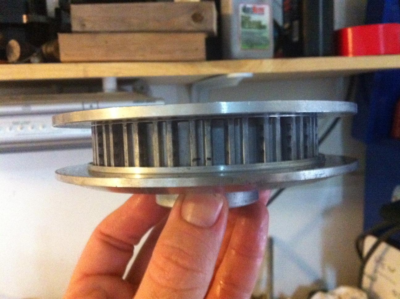

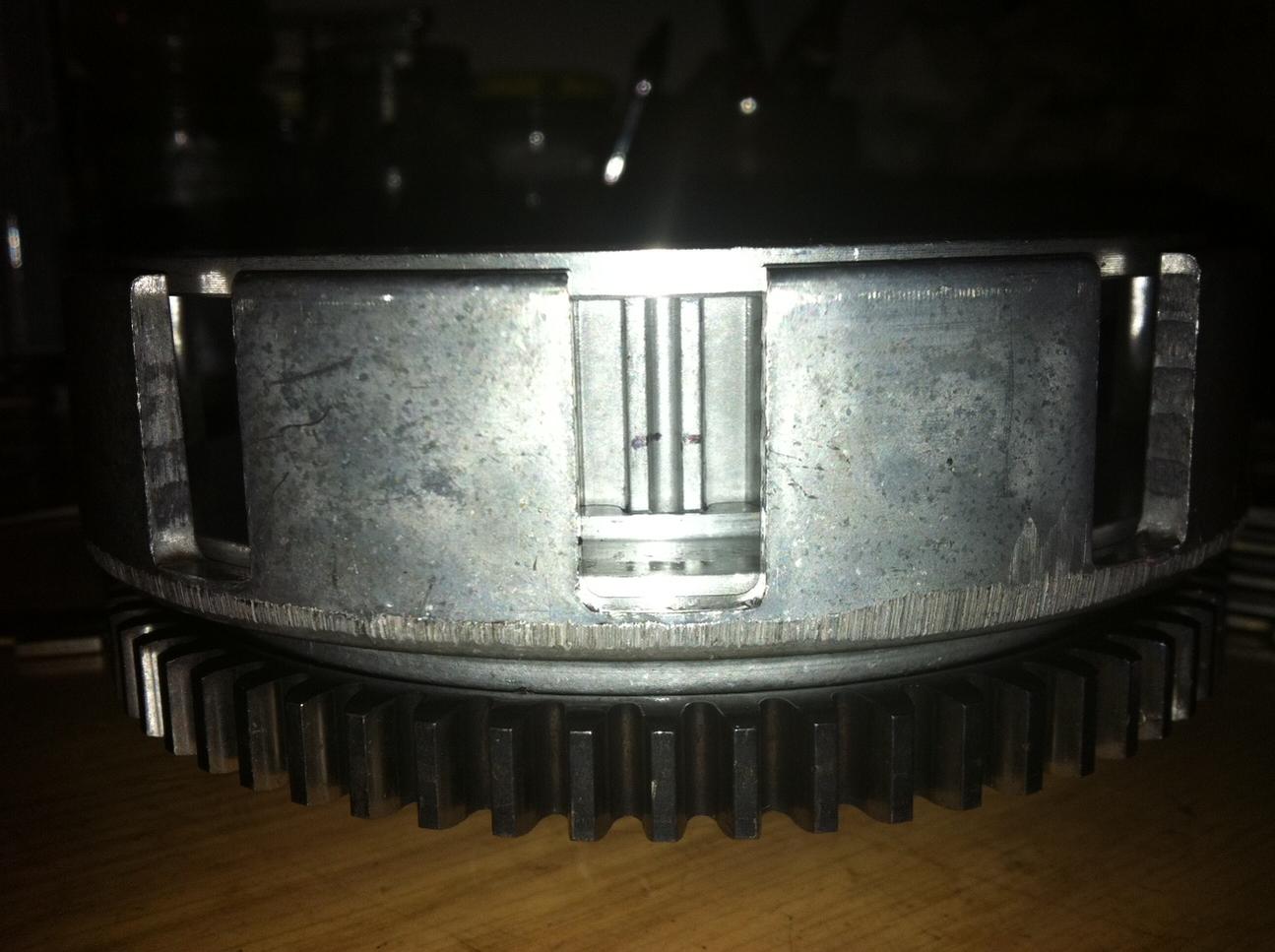

    These are some photos I took of the clutch system. The clutch spring on the left is the new spring and the spring on the right is the original spring. Also notice the difference between the clutch pack pics, the first one is the original pack and the other is the aftermarket pack. The difference between the two is noticeable in the pic and measured .060" total There is a pic of the one way clutch and it shows that there is "outside" stamped on it so you do not install it backwards. Some photos of the the centrifugal clutch shoes.

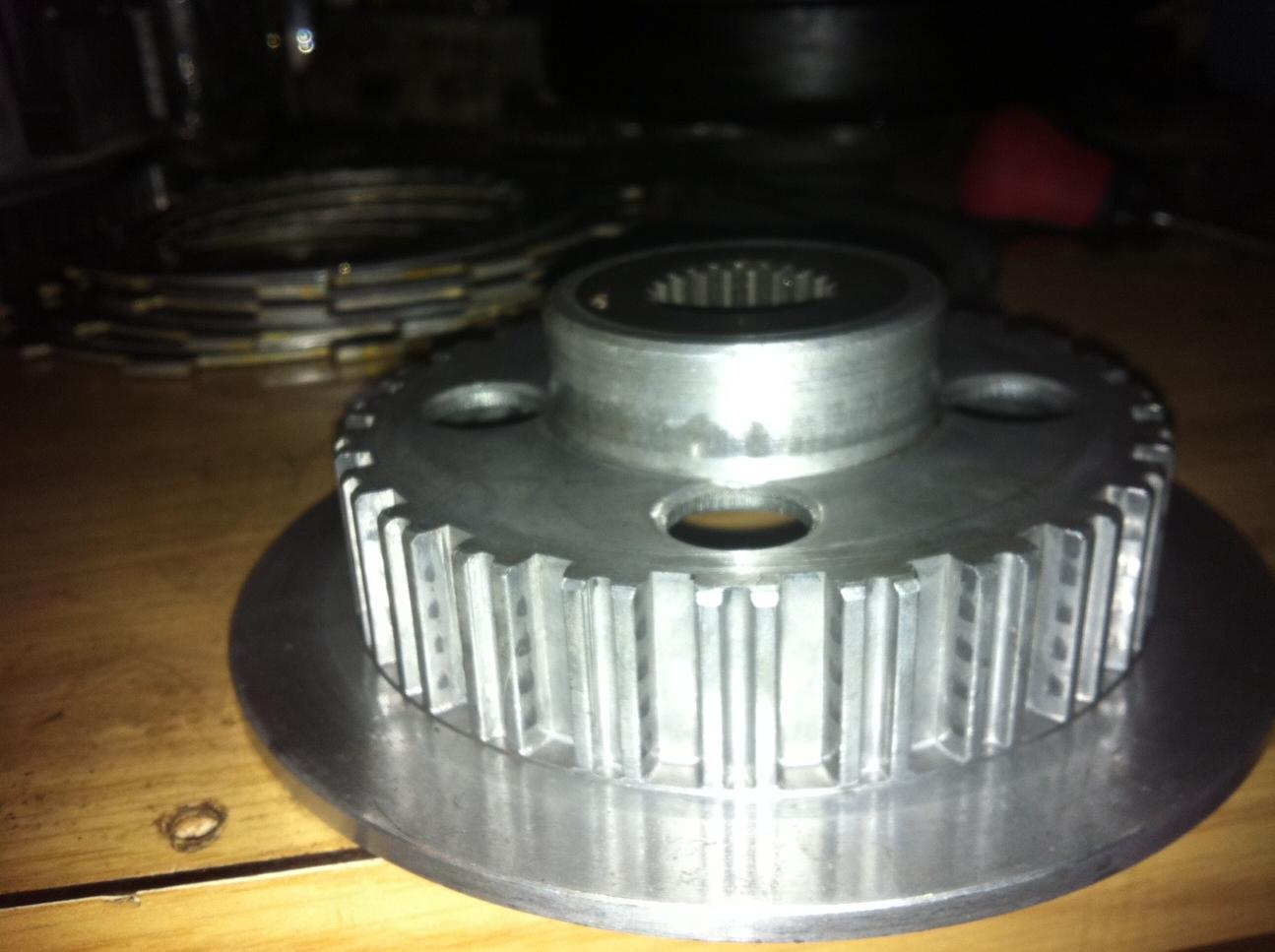

  6. #36
    Jan 2013
    minnesota
    5,911
    Quote Originally Posted by wildacres00 View Post
    Hello
    Ok, that's a start unfortunately I can not view your photos like others for some reason, can you post them to flickr etc and paste a link, i'd like to see what you are talking about.
    I told you how to tell if shoes are oem or not so are they?
    Your short new springs are not guaranteed to be the problem but i'm glad you are reinstalling the originals. Did you do the spring finger pressure test to see if one was weaker or stronger than the other or did you FORGET, lol.?
  7. #37
    Jan 2013
    minnesota
    5,911
    Hello wildacres00
    1. It looks like the clutches do not stack up as high as photo 2 which is what I calculated so that’s ok but the pressure plate has more clearance from the face to the clutch disc why is that it looks incorrect.
    2. this assy looks fine to me.
    3. spring diameter looks nearly identical but hard to tell. Same diameter wire and turns means same spring rate but again I’d use old ones anyway.
    4. can’t see well enough on my phone
    5. does not show the inner hub surface but you neasured it so if it is smooth it is ok.
    6. can’t tell true color of clutch discs so you will have to use my description and photos i supplied to determine if they are oem yourself.

    The color of the shoes appear to be brown as you were saying before but is a little difficult since it was oil soaked. Also I could not remove any material with the finger nail, they are very tough.
    The spring wire diameter appears to be the same.
    The clutch pack does have some space to it. I checked it a couple of times a made sure it was together. I'll take a couple more photos later today. I also took a photo with the spare plates that came with the kit. I'm thinking if I installed the spare discs with the smaller springs that it might work. I'm not going to do that though, Im going to use the old springs with the pack the same as the service manual.
    I'll have to figure out the Flikr account and post the photos and links. I'll do that this evening, it's a family day today LOL.
  9. #39
    Jan 2013
    minnesota
    5,911
    Quote Originally Posted by Howdy View Post
    It is possibly the pressure plate for the clutch disk isn't seated correctly on the groves. The Fix: Pull the clutch, remove and turn the back plate 1/4 turn and see if the clutch pack closes tight and the plates won't turn. You should be able to squeeze the clutch pack together ( front and back pressure plates ) with one hand tight enough that the disk won't turn. If any disk does turn you probably have other issues to deal with. Howdy
    Hello
    Ok, the photos finally sank in, as it sits on the table the above is your EXACT problem. See how high above the basket the clutch center is. Both assemblies have too much clearance from the disc to the clutch center. Remove ALL plates install the splines of the clutch center [outer hub] into the grooves of the pressure plate. They should EASILY go together and the clutch center should enter the splines on the pressure plate by around 1/4”-3/8”. If they engage themselves by LESS than ¼” then the splines are bad and need repair.
    You can put a mark on the splines with a felt tip marker around 1/4” up to more easily see how far they engage each other.
    Take a photo of the top of the clutch center.
    Use old orig springs I guess but it might be slightly hard to shift. Try it before assy and if it is use the new springs.
    Take some photos
    Reassemble with clutches and do as Howdy suggested above before final assy.
